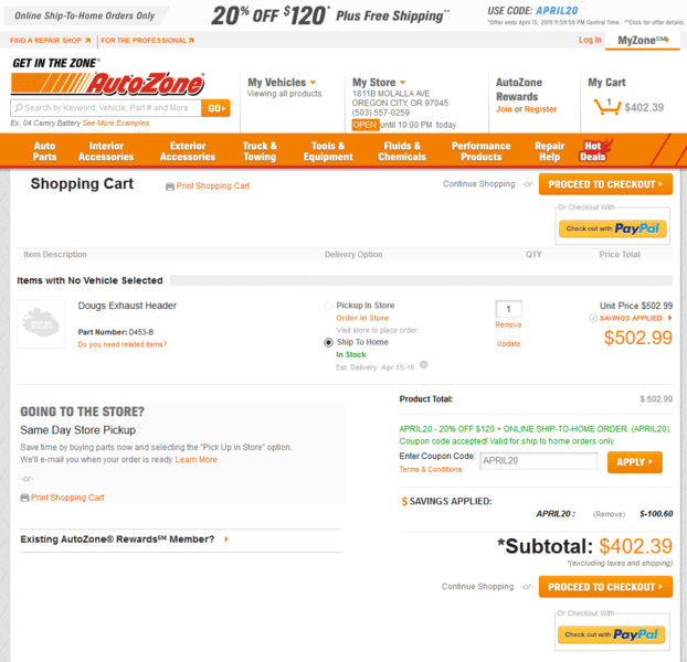

I buy coated dougs every time now. Use the autozone code and the coated are in the 560 range.
