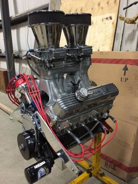

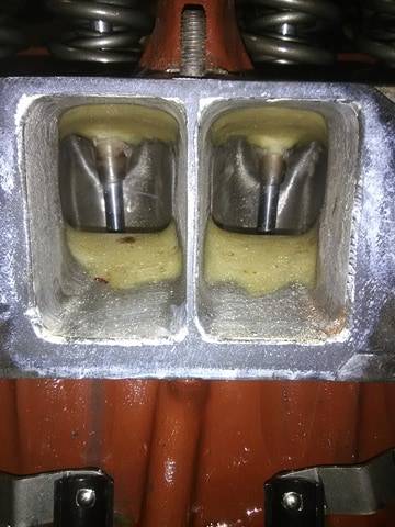

A bit. W2 heads....LOL! Nice canted valves.Awesome, there's some runner work.

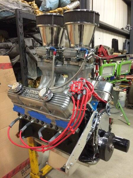

Black is 270View attachment 1716163471

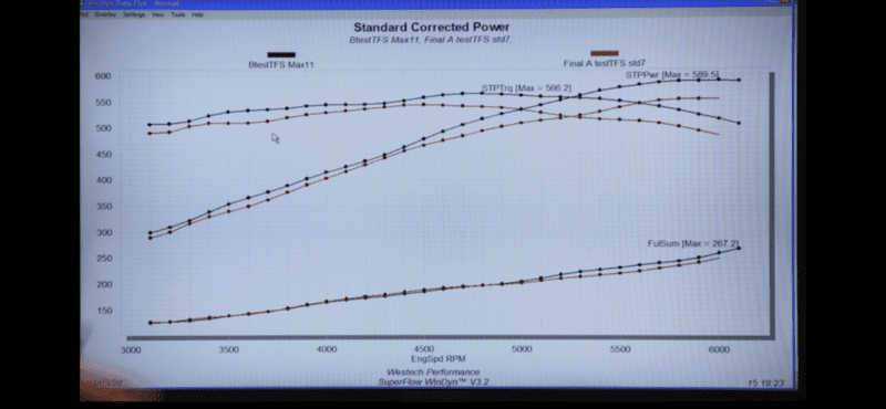

Go watch engine masters season 7 episode 9. Max wedge for a street 440.
The above graphs are a trick flow 240 vs a trick flow 270 MW
No, sorry it was standard to standard but the ports are bigger now on both. I welded the exterior to get a better line of sight and use the gaskets I wantedSo to understand you correctly, you have a modified max wedge style port in the tunnel ram, and tapers into a standard port in the head?

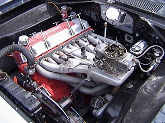

They call those long horn ramsSo are these a Tunnel Ram?
So........Like this? Except Mopar STR - street tunnel ram which is supposedly a laid down version of this except the whole straightened path part..
Yes.So are these a Tunnel Ram?
Post em upSo........
Looking at the Long Rams, Long Horn Rams, Cross Rams, Hyper Pak, etc, don't they fit that definition?
I think we are splitting hairs, they are all tuned ram style manifolds, but for me, a true tunnel ram will always be the vertical layout like the original tunnel ram on High and Mighty. Obviously an OEM can't make such an intake for a street driven car, so you lay it down and get a % of the benefits.So........
