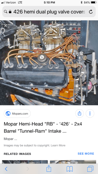

Are those the thin stamped alum. covers ? I couldn't stop the ones I tried from leaking, went back to the stock steel ones.
yes they are the thin aluminum.....we will see. Do...or did they make steel dual plug valve covers?
I only have three sets of them....2 NOS that have never been bolted on a motor, 1 set slightly used / bolted on.
If anything else.....great wall hangers.
If I remember right the dual plug valve covers I borrowed from Jim Hale were the light alum. ones. I could be wrong on that tho. We didn`t have dual plug heads ands used the dual to single adapters , ''or what ever they were called,'' they leaked too! LOL
your memory is still good....that what they are.
the adapters do look a little suspicious, but not much choice for us with dual plugs. ....maybe a thin coat of pooky sauce will help
Someone did make dualplug stamped steel covers, but don’t know who. I had bought a set of chromed ones on eBay, they were modified for bigger springs and chromed. They were vintage. Only set I had ever seen. I had a dualplug accel and trigger also. Sold that stuff to get billet stuff. Big Mistake
