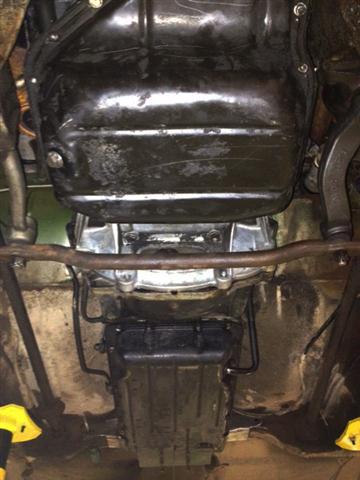

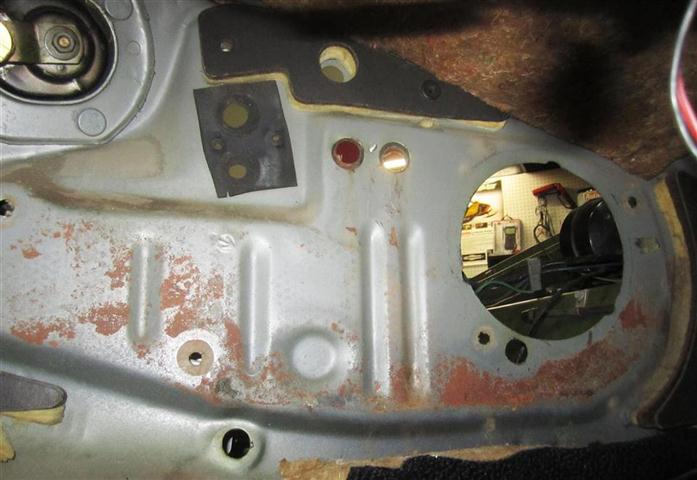

Tonight we got lucky and the transmission is in just about the ONLY place it could be without major tunnel surgery. The trans is bigger than it looks.
There is plenty of service room for trans lines, starter, and linkage which of course is on the WRONG side of the car!

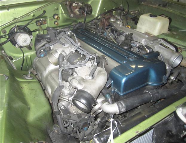

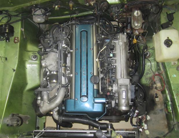

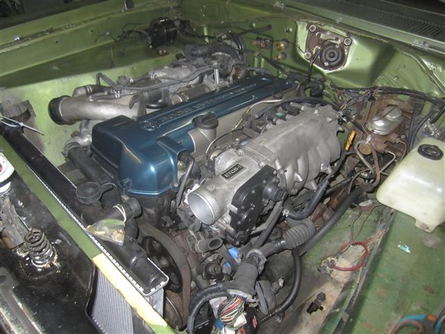

More bay pictures. The engine should actually be quite serviceable from the standpoint of turbos, wastegates, starter, etc. Too much room at the firewall due to some of the chassis constraints. Can't wait to weigh the finished car and I'm afraid to see the final and corner weights frankly. If this thing weighs under 3,500 with big brakes, wheels and suspension I will feel lucky!

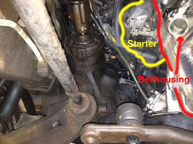

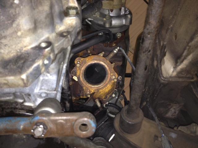

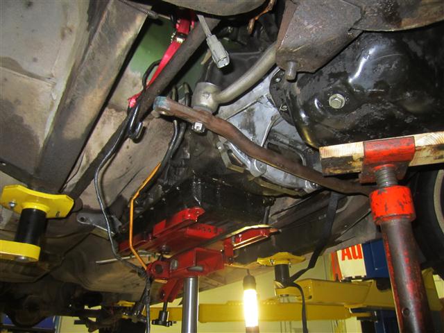

Tons of room for power steering as long as you delete the massive 2JZ Toyota oil cooler sandwich adapter and run a straight one from the block. In fact all of the underside, starter, (same basic location as slant 6), bellhousing, exhaust outlet, etc is a BREEZE to get to and you'd be hard pressed to really fit an engine with the potential to make 1,000 horsepower this easy into a chassis. Of course that isn't our current goal as we will be very happy for 2013 with 350-550 on a docile, automatic daily drivable car. With all of the systems we have to touch to take this from Scrapyard to street horsepower upgrades will just have to wait until we make it a CAR again! Those 1,000 hp Supras you hear about have expensive 6 speed manual transmissions, giant single turbochargers, and stand alone ECU's!
Now I will say this; any idler and pitman arm will be close to the Supra's mid/rear pan sump at lock and we had to go back in and raise the mounts about 3/8" last night rechecking driveline angles again so that's a bit more non value added work. A custom Stef's pan or Aussie Toyota Crown pan would solve all of this but we're trying to get this done without too many exotic bits and pieces.
Here's a few pics for reference:

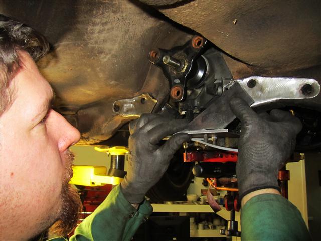

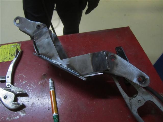

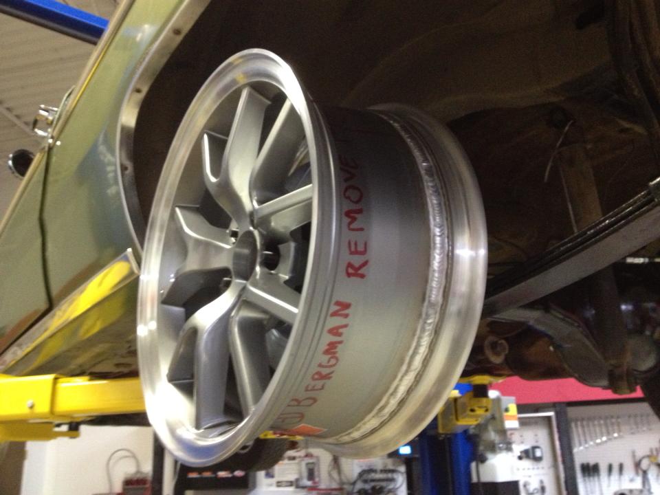

Over the past couple of weeks we have built a core support for the Supra Radiator and stiffened the front frame horns in the process. Tons of parts showed up from Bergman Autocraft. Due to time constraints we just couldn't do the spring relocate as much as we wanted to it to allow larger tire options. As it stands we are going to try and slip 245/40/18's all the way around on the car.
I'd like to stress that to swap this engine you don't absolutely need to make it a cut and weld project. The thing is we wanted to upgrade some things and package things like a fuel tank without killing trunk space. This IS a car we plan to drive mind you! Tim likes to weld as it gets him in the mood to work on his 70' Dart project!

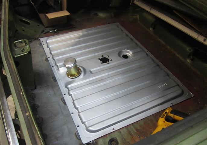

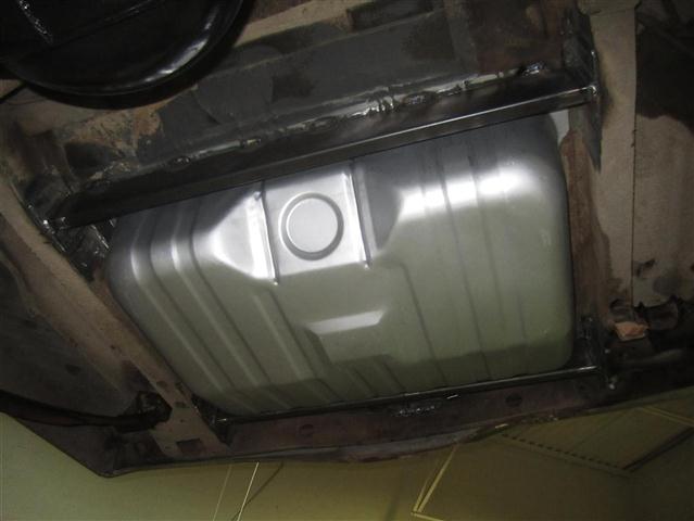

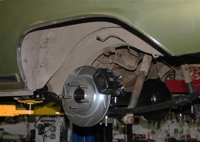

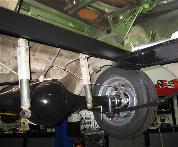

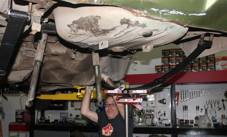

We've installed our 8 3/4, 3.91 489 case rear end and mocked up Bergman spec'd Dr. Diff Cobra brakes. Tim and I also got the Tanks Inc. 1960's Ford Mustang EFI fuel tank installed and that decision gave us room for our water to air heat exchanger between the axle and fuel tank. We also added crossmembers on each side of the tank and that should also help stiffen the frame. The crossmembers are light and only add about 10 pounds to the rear of the car.

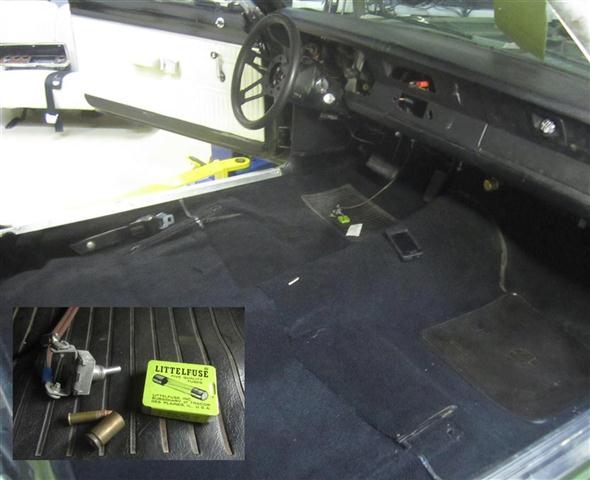

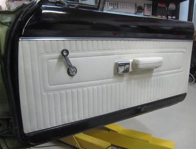

More work from the weekend. Tim took some R&R with his family so I worked alone. Took interior and HVAC out. Carpet and door panels in amazing shape. Test fit Hellwig sway bar and TTI 3" pass side tailpipe. Painted crossmembers. Car is starting to look better the more we touch it.

1) Bergman/Firmfeel/RMS Suspension Install with Hotchkis Springs/Dr. Diff Cobra Mustang Brakes

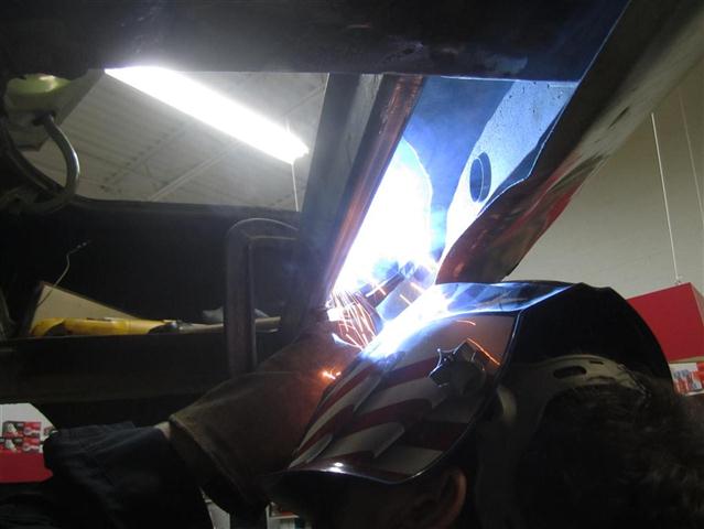

2) Timmy Built Subframe Connectors

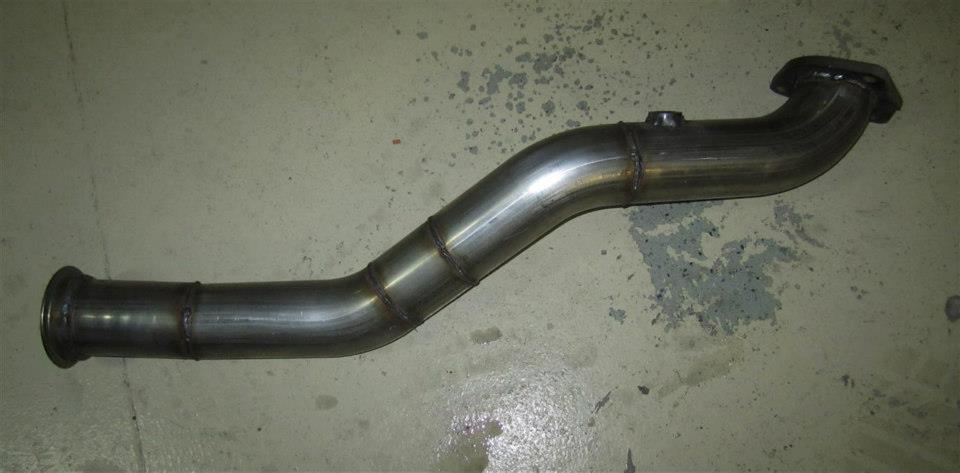

5) Exhaust System fab and Installation

7) 1967 Mustang EFI tank installation.
