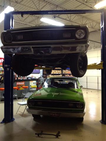

i went and looked at the car last night and it going to be a sweet project! its going to look great when me and dave get done with it. i cant wait to get started!!!

If you guys had EVER seen the quality of Tim's work upclose you would #1 buy his Turbo Dart and #2 Beg him to help you build a sweet car!
Tim and I worked together on 4 cars at a previous job and his work was impeccable, the cars exceeded the performance we promised. When I win the lotto or make it some other way I'm giving him a Mil to open up his own place!

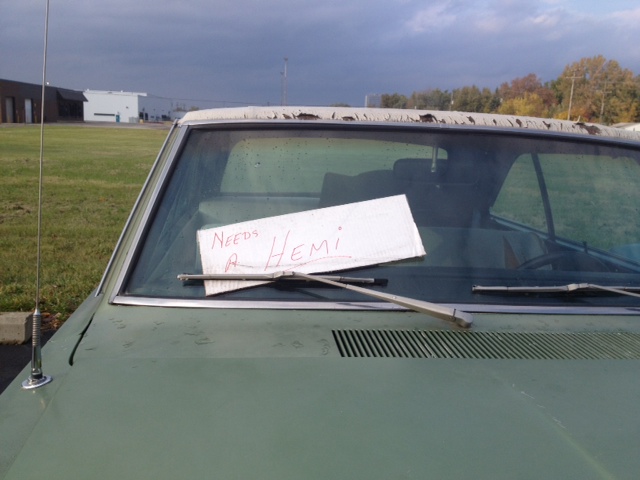

Nice! Comments appreciated. FWIW, I came to the shop to find a "needs a hemi" sign on the windshield today. The neighbor knows what's what and I'm pretty sure his doo wop penmanship is at hand here!
Tim and I had a FedEx parts delivery setback and the Supra mid/rear sump oil pan didn't arrive until late Saturday night. We are going to try the Supra mid/rear before grabbing an Aussie Toyota Crown for $700 or fabbing a Stef's custom for $900.
Keep in mind that the effort I'm doing now is so that pretty much ANY A Body enthusiast can duplicate this effort without snowflake, unobtainum parts.
"Needs a hemi".......... that person obviously does not understand the power potential of a forced inducted engine. replacement for displacement! i would put my non "hemi" a-body against an a-body with a "hemi" any day! and you better believe i have!!!
