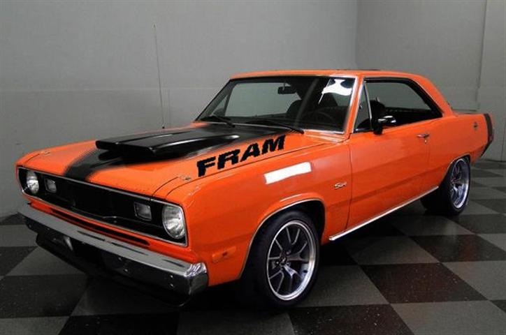

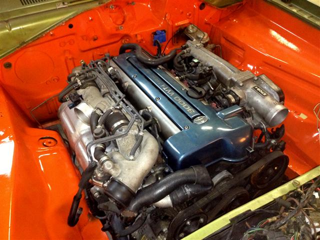

It's a shame that nobody loves this project except for a few of you as it's coming along nicely. UPDATES Our engine is back in after final fit and sealing, Firm Feel gear box mounted and we cut in the engine bay for paint. As I work for Fram we will be using this car in Orange for our promotional events this year. We are sponsors of the Hot Rod Power Tour, Car Craft Summer Nationals and we have to work overtime to get the car done for the events. Please hit us up if you are going to be nearby so we can meet up.

Cool project. What is your power goal to the Tires?? HP/Tq and at how much boost?
This year I will be happy with 320-330 RWHP on stockish parts. While the 2JZGTE is known for being able to produce 700 to over 1,000 horsepower in racey turbo trim I think that 450-550 horsepower will be fun enough for a daily driveable car.
