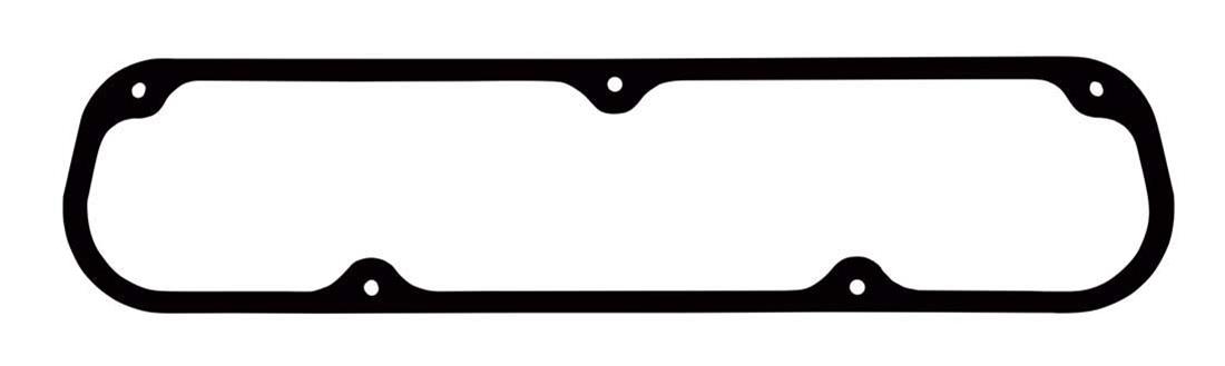

DODGE Mr. Gasket 5876 Mr. Gasket Ultra-Seal Valve Cover Gaskets | Summit Racing Same part number. different photo here.

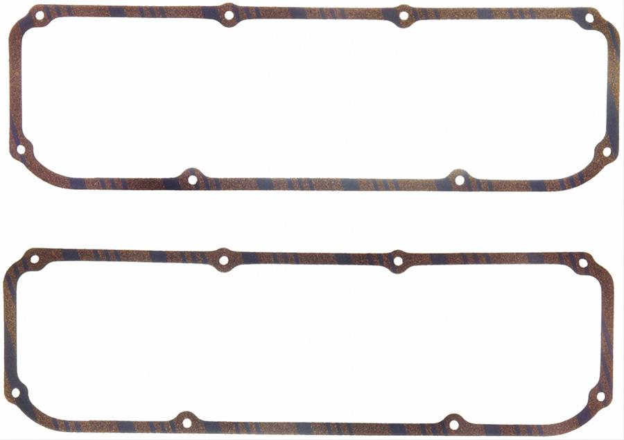

Fel-Pro 1612 Fel-Pro Performance Valve Cover Gaskets | Summit Racing

DON'T USE THESE!!! I swear by Real Gasket's Thermostat housing gaskets, so I tried the Valve cover gaskets. These are silicone gaskets with no solid shim inside. On a 5 bolt small block valve cover there isn't enough rigidity to keep them from squeezing the floppy silicone gaskets out from the edge between the bolts. They leaked like a sieve.

if you're going low rent, just get the standard fel-pro cork ones. a little high-tack of some sort and send 'em. just know that if you gotta pull the covers the likelihood is that you'll be replacing them.
