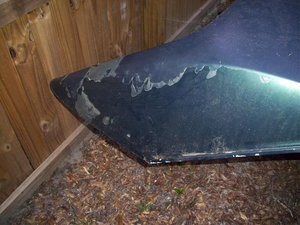

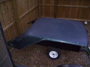

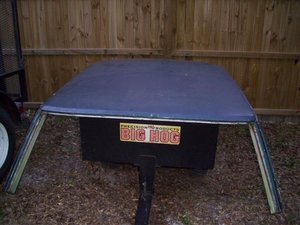

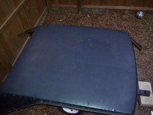

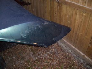

this is my 71 dart swinger i just pulled the vinyl top off of and the rot is pretty bad what do i do how do i fix it cAR.jpg
Find a donor car or make patch panels and weld them in. Whatever you do don't just fill them with filler.

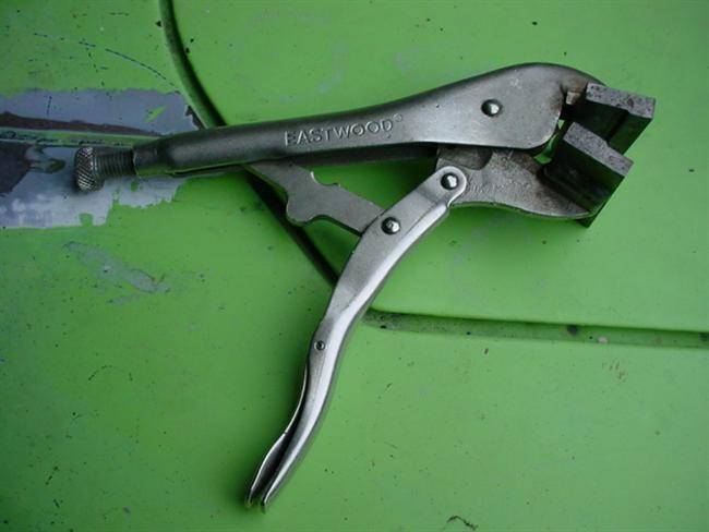

I cut panels larger when possible and use the Eastwood flange vise grips to flange the patch to over lap on the underside.

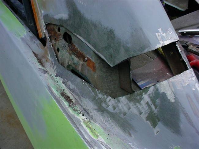

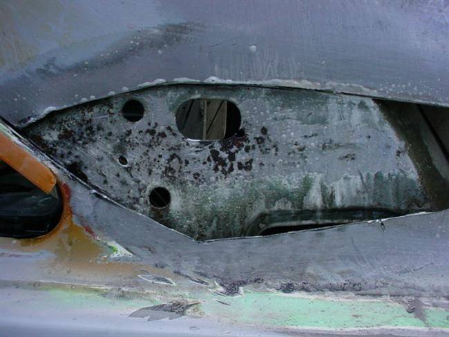

My angle grinder died(good thing to, it was dangerous)so this is as far as I am on the roof seam.
It looks like Frankinstein becuase I cut my patch into pieces to fit it better and I needed to cut more rust out that I noticed.
