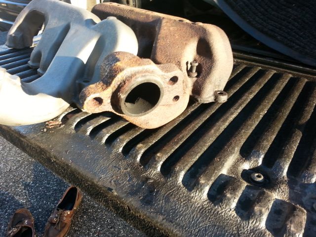

Hello,
Placing in my 64 Dart a mid 70s 318 and 904 tranny.
I see talk about exhaust manifolds and that the driver's side is not a standard one. Is that exhaust manifold only NEEDED with power steering?
My car has manual steering and just looking to clarify what I have to get for exhaust manifolds to make this swap work.
Appreciate the help. Thanks.

You need a drivers side exhaust manifold that originally came in a 64-66 Dart, Valiant, or Barracuda with a 273 engine. That particular manifold is unique to the 64-66 early A body V8 cars. Passenger side manifold can be any center dump 318 manifold. Nothing special about the passenger side manifold. A driveshaft out of anything with a 904 transmission will work if you get it shortened, or you can hunt for one out of a 66 Dart or Valiant that came with a 904 and 7.25 rearend. Good luck.:)

You can use a 67 up A body gas pedal/throttle cable. A V8 one for the right cable length. just redrill 2 holes in the firewall for mounting and the larger hole for the cable itself to fit thru. The OE one is pretty hard to come by. (2) different 360 pans I've dealt with: the 876 has the sump starting ~2" from a plumb line straight down from the pan very front pan lip and the 392 is ~4". yes 360 pans will not interchange but just a heads up as the 318 pan in my 65 dart (not sure the #) had a lip that started ~4" back just like the 360 392 pan did. Someone will give you some more info on that issue if needed. If the mag manis fit I would HIGHLY suggest them & the 92/early 93 versions with the 2&5/16 outlets as opposed to the 1&7/8 restricted bend 273 V8 ones mentioned (I used them tho as that was all I had at the time. Worked fine for a DD. iirc the later mag manis also have 1&7/8 outlets.
Very good wrote up. Thanks! I have already purchased the 273 manifolds. This is dàily driver only and maybe some spirited driving on occasion but I'll know what's needed if I want to step it up to higher performance in the future.
