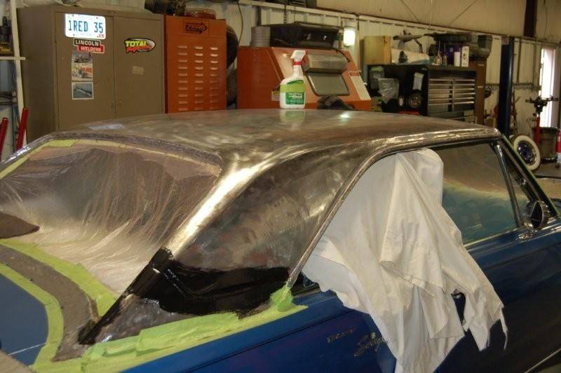

Most of the grinding is done, and some POR15 applied.
Some small areas had to be welded and repaired, but overall it was in pretty good shape under the vinyl.

The guy doing the painting put down two coats of primer yesterday (May 27th) on top of the POR15, so it should last awhile. The next step was to check with the vinyl roof and headliner install guy to see if he wanted them to wait until he was done with the roof to put in the rear window and new windshield. The roof underside/interior has a coat of POR15 on it, too.
