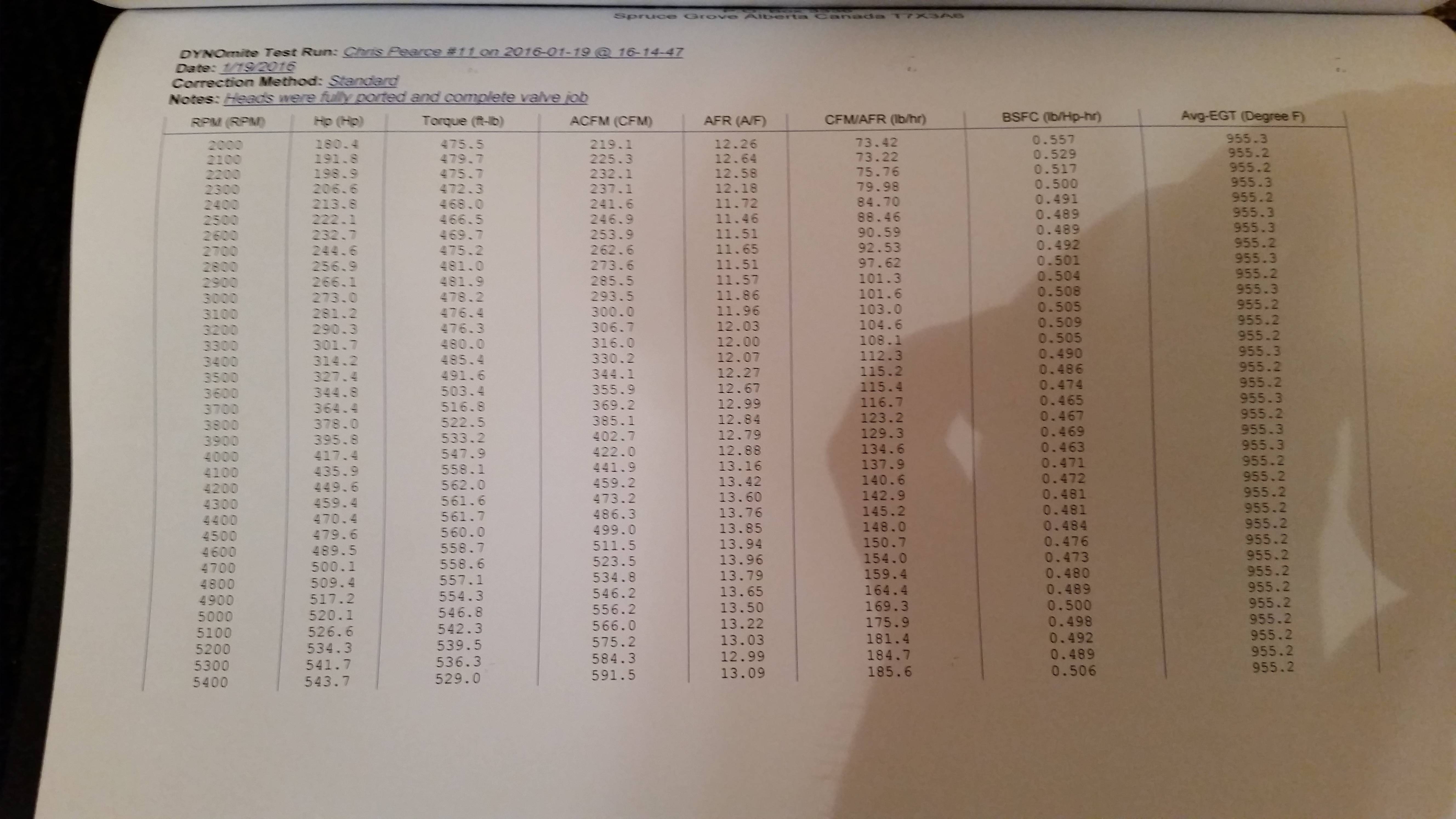

Another Canadian......I am wondering what you used for your crank pulley with the ATI dampner. We have similar projects but mine is a '70. My 340/416 made 560hp/530tq.
Looks awesome!! Great power numbers also. I actually used a single grove big block chevy pulley lol. My ATI balancer is a hybrid with a mopar crank snout on rear side and a chevrolet bolt pattern on front face. We had to custom machine a spacer to go between the balancer and pulley for proper belt alignment. Nice to see another Canadian. What are the details of your build?
Is there more to this dyno sheet Chris? I only see up to 5400 rpm is why I ask. Surely this engine peaked around 6100-6200 rpm. J.Rob
Hi Jesse,
Lol, no we did not pull past 5500 (on another pull). Reason for this is I was more than happy with the numbers we had already achieved and did not want to push limits of stock block. My car is 90 percent street and occasional track so extracting every last bit of power was not of top importance. (Actually exceeded my expectations as it was) The dyno session was mostly for safe break in and tuning of Engine. We tried to simulate real street car testing using pump premium, safe timing, safe jetting, and water temp of 175. In this rpm range the hp gains per 100 rpm were greatly reduced. I suspect with agressive tuning and more rpm this engine would likely reach 575hp but for my application we didnt see the need to push it that far. My hope is that this engine will provide me with years of trouble free street service. Out of curiosity what rpm have your safely pulled an LA engine with hydraulic roller cam, I realize 5500 is well below the limits.

Sorry Chris I went back and re-read thread from beginning. You answered everything on the first page-D'oh! I also just realized who you were, double D'oh! Sometimes I'm slow. Did you sell that intake I ran in the 2010 EMC?
Your guess of 575 hp sounds very plausible. I have turned 6750 rpm with a stock stroke 360 with W2's and hydraulic roller lifters, 238 @ .050" .640 " and observed 533 hp . I'll say it again LOVE W2's and your unassuming looking build. Put it in a Cordoba/Diplomat/Mirada and you will sucker every brand X'r you meet. Take care, J.Rob
