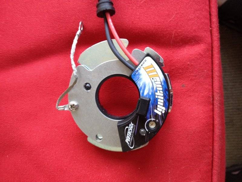

                          Not considering the Pertronix?
                          Flamethrower III + coil. All hidden, ballast bypassed from behind, absolutely no fitment issues. Must run resistor wires, solid core is a no,no!

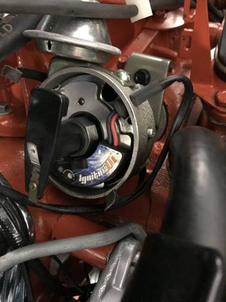

                              Just the Flamethrower III module that fits my Chrysler points type dizzy based on the dizzy part number. Bought the coil separate after realizing it was required. Read and understand the instructions. One extra wire that is included and I shrinked wrapped to hide it from the dizzy to coil based on a pure stock point dizzy! A short piece of #12 solid copper soldered in to bypass the ballast from behind. Pure simplicity and awesome performance!

                                Module and module installed. It reads the points cam.
