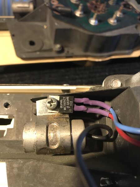

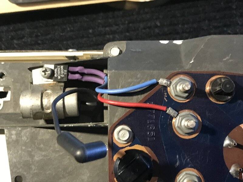

I’ll include pics of the modded instrument voltage regulator.
Thanks in advance to all you guys for being so helpful.
Well and I was going to say ground the cluster, by employing a dedicated ground pigtail. Other than that, you moved something or shorted something, and damaged the IVR circuit.
When I took the cluster out, this is what it looked like. The previous owner modded it. I don’t know what’s been done internally to the original IVR, but the gauges were working properly
Try the dedicated ground. Some research suggests that without a ground the 7805 passes it's input voltage.
Don't let the gauges peg. You will destroy them.
