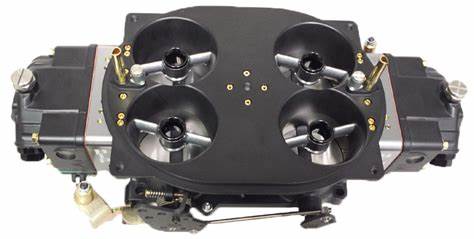

I ran a 1050 on a 416 out of the box, added a 2.5 power valve and larger air bleeds, Worked perfect through RPM's with a rich lean gauge on each bank to tune it. I started with an 850 went to a 950 and then a 1050. It like that 1050,
