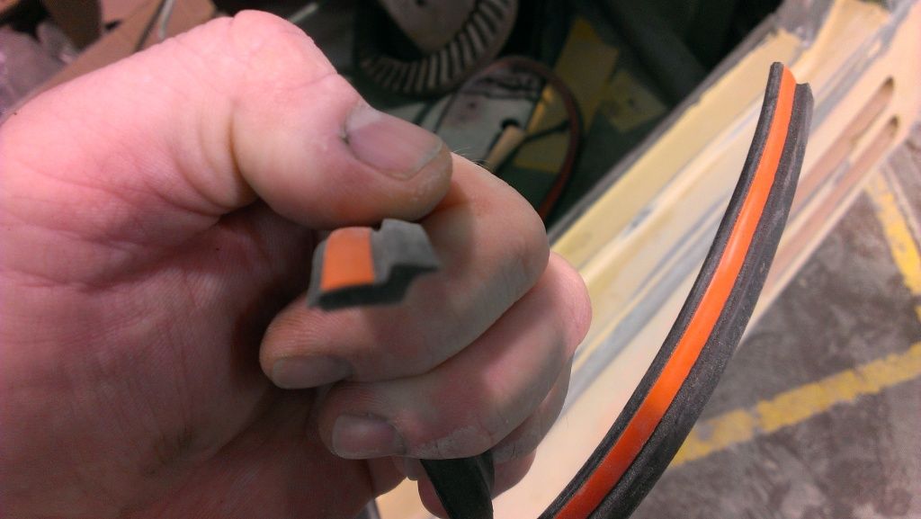

Sorta. Usually the glass has a gasket around it and then the trim goes around it. I'll be welding a shelf under where the glass would sit so the glass sits flush with the body then I will glue the glass in and use a modern style rubber moulding around the lip of the glass.

Very appealing idea. Is the rubber molding a generic piece cut to fit?
What about the rear glass?
Yeah it's attached to the underside of the glass and has its own glue on it. I'll take pictures of it when I get to work today.
