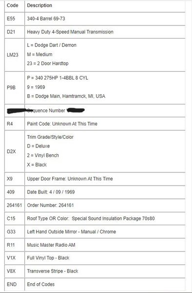

By the way R4 is Bright Red
Toss a picture of it here.
I think officially Dodge calls it Charger Red but I'm no expert. It sure looks orange to me. Somewhere I have pictures of it taken back in the 80's but they are not on my computer. I'll take a picture and post it when we unearth it.
This is my original paint R4 example. Lots of people see it as orange which I tend to agree with as it definitely has an orange hue to it. I thought dodge referred to it as "performance red" ?? I believe R4 was introduced after the start up of the 69 model year.
X9 upper door frame unknown at this time is black in colour. I'm sure your aware but just in case thought I'd mention it.
Good luck with it.
That's pretty much the same color as this Dart. I agree, sure looks orange. And yes, it does have a black interior with black upper painted doors.
