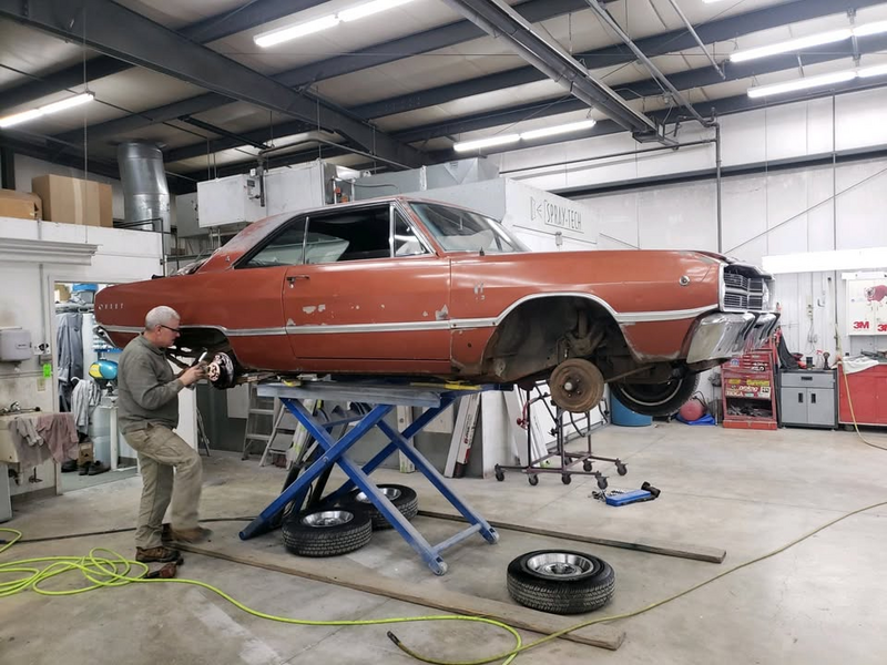

Mid-rise scissor lift. Usually rated for 6,000 lbs. I have one and it works very nicely. I usually get the car up in the air and then bring it down onto wheel cribs made from dimensional lumber. It's pretty solid on its own, but I don't trust anything when I'm underneath it. If the wheels have to be off, there are extended jack stands for use with lifts. They are mobile, but they weigh over 1000 pounds so it isn't like you just throw them around. Moving takes planning and hopefully a smooth and level floor.

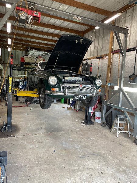

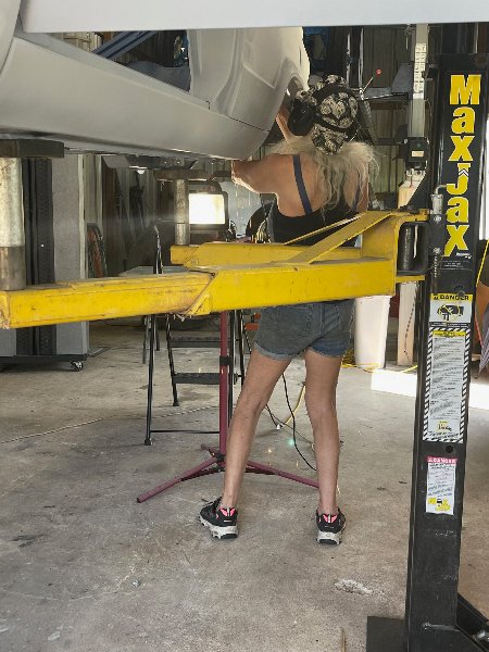

I have the MaxJax two post lift and have been very happy with it for about 12 years now. I am able to do virtually anything that I can imagine with a vehicle on it. Have done transmission swaps, (I have a transmission jack that fits underneath), dropped out fuel tanks, dozens of brake jobs, wheel swaps, engine swaps, exhaust work, front end work, the thing is fantastic. I would love to have a full lift hoist but I don't have the room for one, and at 6 ft 7 inches tall, there are very few lifts that I can really walk under anyway. Price wise I think they are fairly close to the scissors style and can easily be moved to make room if needed. I take mine 'down' every fall since I don't have heat in my garage and I typically want the maximum amount of space to put 4 vehicles in the garage over winter.

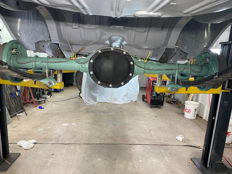

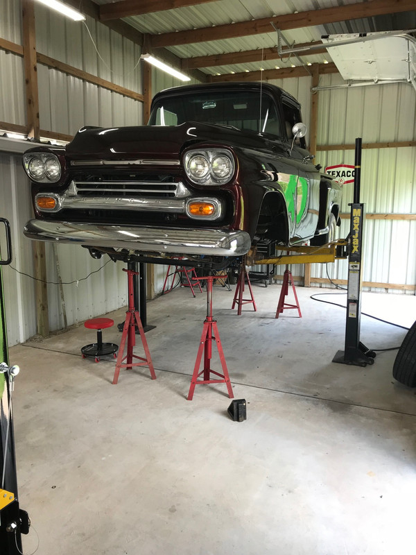

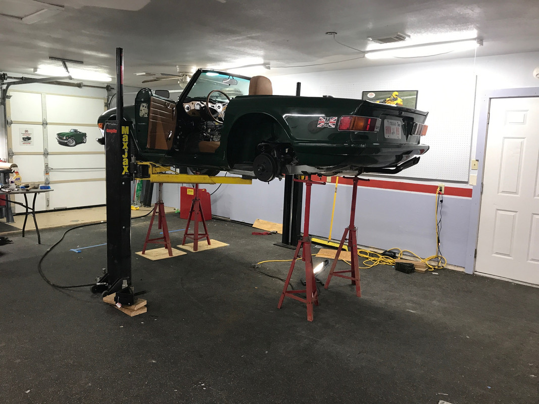

I went through this process of deciding what I wanted in 2008 when I was getting into "restorations". I looked at the mid-rise and still think they have the place especially when room is tight. I do like the fact the MJ (MaxJax) can be unbolted and rolled out of the way. I have two maxjax systems and one extra column. I have three places I can use them. That is another drawback having to drill holes in the concrete. The width I have mine mjs mounted are 118" from outside to outside. It's just the darned versatility of the MJs are super. I see used ones pop up on FB market place now n then.

ps: I guess another drawback is most the time you cannot open a door fully, and the larger the car, the worse it may become. Perhaps if I had widened the columns, it might have eliminated that.
notice the low tall jack stands, I feel are a must to have, plus I can remove the maxjax posts.

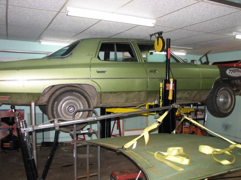

and notice here the added pad extensions, 6 + 3" here.

I don’t have the side clearance in my two car garage to fit a two or for post lift and still have my wife’s car fit. The mid-rise stays completely under the car. Yes it is a compromise, but in my case it provides a solution to my lack of floor space. I looked at putting an addition on the garage but it would have been nearly $50k and in the end the city wouldn’t give me a waiver for the drainage easement on that side of the house. I picked mine up used for $1200 and it’s done everything I’ve needed so far.
