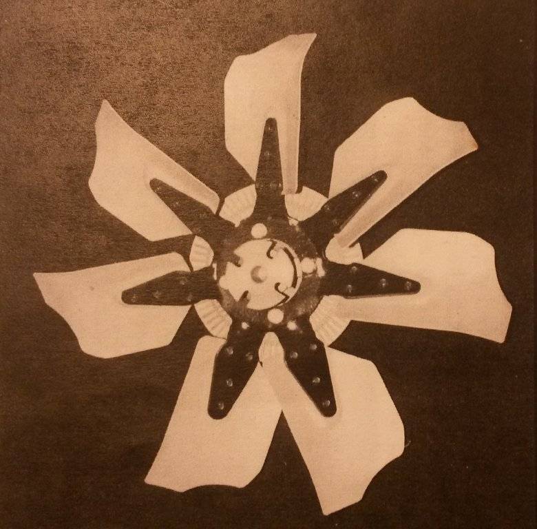

Non thermostatic and 7 blade in picture I posted.

This picture from the SS Guide shows typical pattern of the rivets you found on the fan of the SS Hemi.
Thais is wrong
I also bin questioning this fan and clutch set up. I talked to Jim shields about this. Jim used a generic fan for the picture. The one in the picture is not correct. I sup possible have an original one off a factory SS car. 070 clutch and the fan is aluminum blade
correction I should have said fan looks correct but not the clutch (aftermarket)

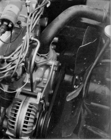

Wrong fan maybe, but I´m referring to the pattern of the rivets, and that is correct.
If you know what to look for, this old picture clearly show rivets are placed in the same pattern as fan pictured in the SS Guide, and of cause the fan in your pics... Thanks for sharing them...

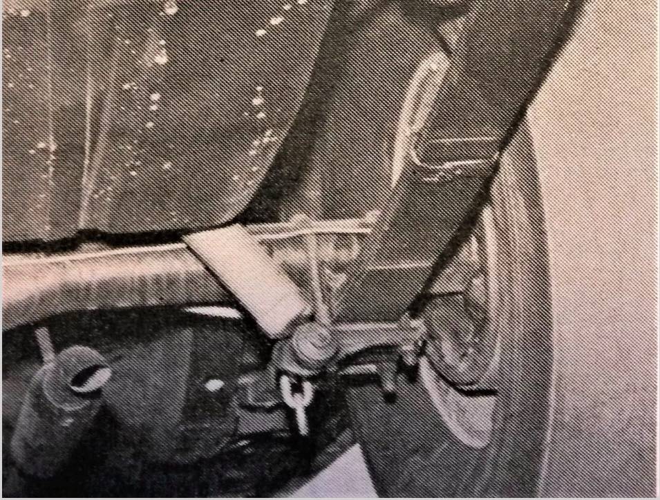

from the spring to the backing plate. If it was a b body rear it would have a lot more space.
That picture above looks like an 8 3/4.
You must remember that the rear wheels where also modified. The centers were pushed out an extra 1.250 to account for the wider rear end. Chrysler new that the racers were going to tub and narrow the rear end.....they just wanted to make sure the racers had parts they can work with and modify on there own.
In that picture the rim has a lot of back spacing and a slick tire. Look how much "bubble" the tire has and that is why the tire is close to the spring.
Here is a picture of my Dart. B body 8 3/4, Super Stock springs with the correct offset hangers. The differential housing length is not modified at all. Just the saddles have been moved in so the offset hangers can be used.
davescuda , isn't that pics of a 8 3/4 r/e , see the tubes getting fish mouthed at the left of the housing .dana tubes are straight . and i thought the b super stock dana was 52'' axle flange to axle flange ?
you guys are right with 8 3/4 but goes with the whole theory of B body rears the spring is to close. I think I have another picture.
I talked to Arlen Vanke (RIP) about this and he said they where not 68 B body Dana's. He said they were Dana's built for these cars. Just going on what he told me.
Are 67 B Body Dana's narrower?
From the original cars I have seen there was a space between the seat cushion and back. This observation is based on 2 recent auction cars and 2 original cars a local person has in his collection.
Again just based on what I was told...so take it for what it worth...the person I purchased an original magnesium manifold from which was purported to be from a LO23 car....had a Dana which was again supposedly from that same LO23 that I also purchased...it was a B body Dana. And measurements of this axle are the same as a M code A12 RR. I do not say this proves or disproves anything just a contribution to this on going conversation. Just an observation. Nothing more.
