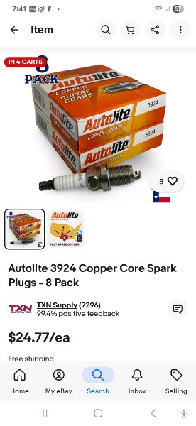

I don't know about race plugs. I think I got these Autolite 3924's at O'Reilly's for about $1.80 each about 3 years ago.
Must be nice. Those plugs and the NGK 6962 are $6/ea up here.
Summit shows them at $1.99 each. Here's an eBay ad for $25 for 8 plugs.
