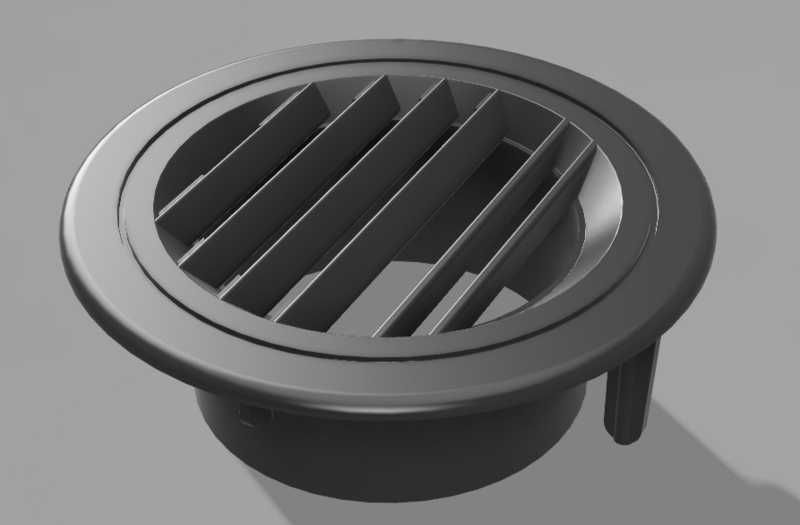

I will probably have some time next week to model these in Fusion and make an STL I can share. I would do a test print and fit before sending out a file.

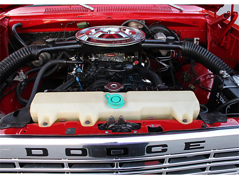

How about a coolant overflow bottle for the ‘74-78 dodge trucks? They don’t make reproductions…and are in somewhat high demand.

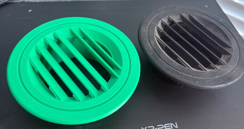

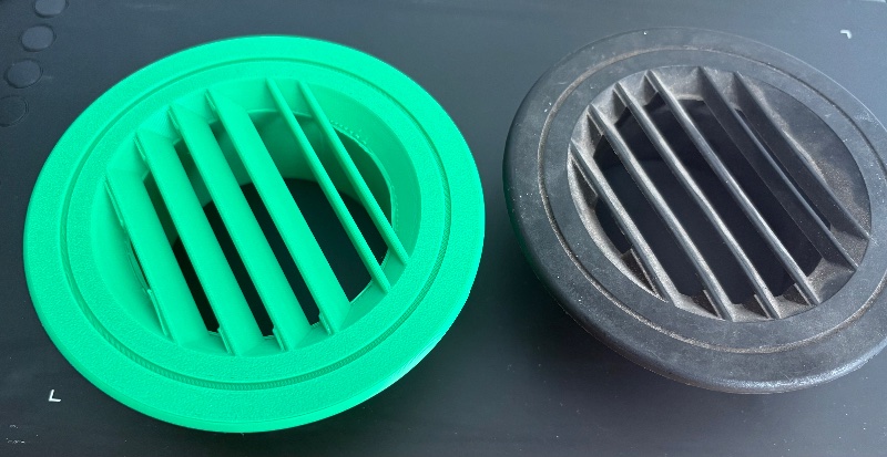

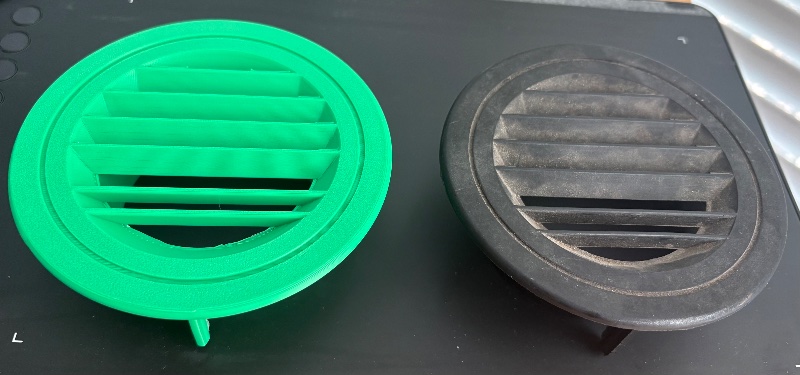

I say it looks pretty close. I’ll do a PLA test print next week.
PLA test print worked out. First iteration I had a few things I needed to tweak.
I need to pick up a smooth print bed plate, the texture is a bit much.

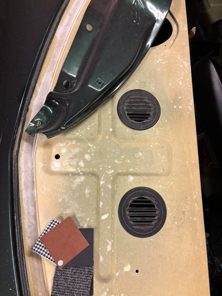

Does anyone know definitively which way the vents point? I assume outward, meaning the angled blades point towards the side. Would kind of make sense for the rear window considering placement.
View attachment 1716496920View attachment 1716496922View attachment 1716496921

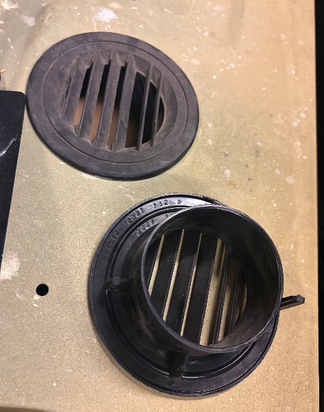

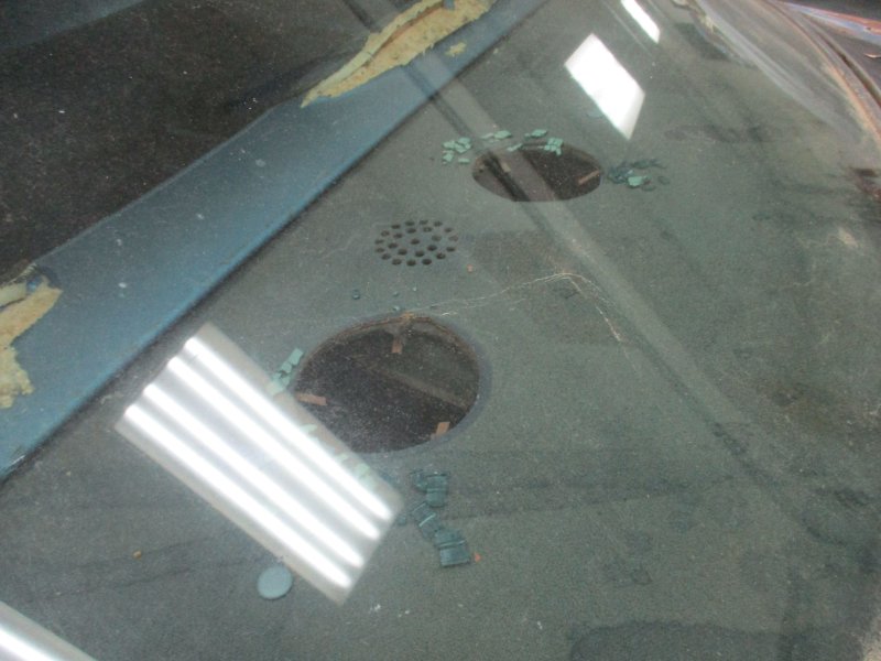

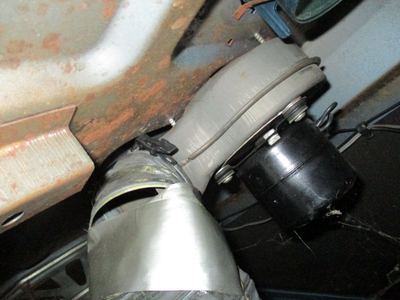

I thought I had a picture of the damaged vents before I removed them, but apparently, I don't. The pictures from under the package tray shows the long tab on the bottom of the part aligned with a slot in the metal package tray. I think this would fix the correct orientation. That tab on your part appears to be shorter than on the original part, so it might need to be lengthened some to use it as an alignment pin. Your part that you printed looks great. Thank-you for taking on my project. Not sure how many folks might need a set of these, but I for one do.
Regards,
John
Regards,
John View attachment 1716497519View attachment 1716497520

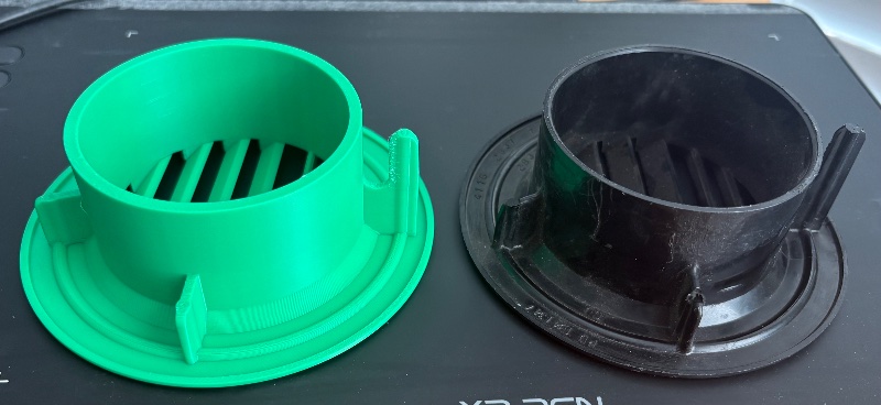

The tab on my printed part is same length as the stock ones I have, the hole in the sheet metal is large enough that it does not fix the location of the vent. I would assume that the factory package tray has slots to locate the vent. If the long tab is oriented as you show then the vents point the direction I assumed they would (see picture below). Are you the same person on Facebook that messaged me and wanted them printed in blue? I should have everything I need to start printing these in ASA by next weekend.
The tab on my printed part is same length as the stock ones I have, the hole in the sheet metal is large enough that it does not fix the location of the vent. I would assume that the factory package tray has slots to locate the vent. If the long tab is oriented as you show then the vents point the direction I assumed they would (see picture below). Are you the same person on Facebook that messaged me and wanted them printed in blue? I should have everything I need to start printing these in ASA by next weekend.View attachment 1716498097
The package tray doesn't have any locating slots either. I think how you show them located is correct.
I didn't message you in Facebook, at least I don't think I did. However, my originals were blue. If they could be printed in a blue that was close to original that would be great. If not I'd paint them the shade of blue that I wanted, assuming they were printed with a material that can be painted
They can all be painted just like normal plastic. An adhesion promoter helps, I usually just use a high build primer filler. I send out all the tags in raw format so that they can be painted body color
In his case I can print in ASA a color that will probably work out fine. And, if he wants to paint it he can.

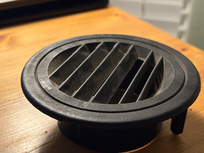

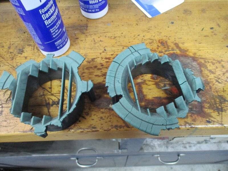

I'd be interested, if anyone has a set I can borrow. They don't have to be in good shape. Even the questionable item in the photo would let me copy some key dimensions.
