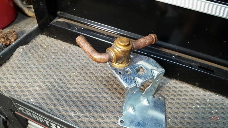

I just purchased a new valve for my 66 Barracuda with air. Try www.heatervalves.net He is in Superior Wi and he found a new valve for me . I have a new valve for 1/2 in heater hose that is just like the correct valve for a Barracuda or Dart that I would sell.

This is the valve that looks like the one for a Dart and Barracuda only it is for 1/2 in hose. The vacuum actuator bolts on and can be switched to a new valve.

There is nothing more than a flat coin like baffle in the pipe. It restricts water flow but cannot stop it completely. If they were a true valve like a ball gate valve, I think there would be some mention of burping/filling the heater core in a service manual.
If yours is passing a lot of water when turned 90 degrees to the pipe, maybe the baffle is rusted away?
