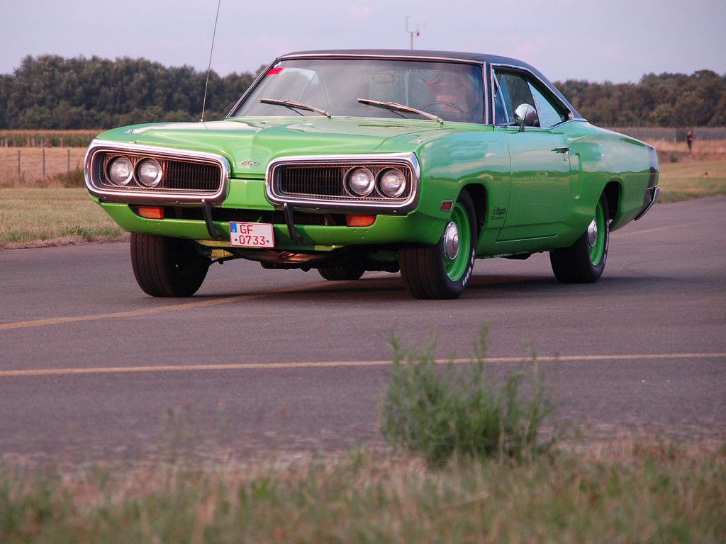

Front......205/60R15
Rear.......245/60R15
Thank you Dreno,appreciate it. Car looks great.

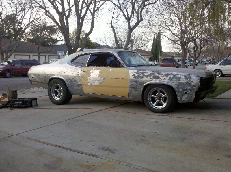

I'm running 245's, on a 15 x 8 had to do a lil fender trimming but after that there is no rubbing. i'll see if I have a rear facing photo
What was the backspace on those rear rims. And what rearend did you have in it.
The stock 15x7 Mopar rim is 4.25" backspacing. Rarely will an aftermarket rim have that same exact backspacing.
15x7's with 4.25" and small bolt pattern original 8.75 put my 245/60/15 in my 68 Dart about dead center. And there is some slight tire rub, because my leaf bushings and springs are shot. This is close and it's just one car.
