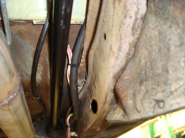

Not much going on today but I had a chance to run the wires under the car. There was a existing hole already (didn't want to make another hole in my body) so I found a perfect grommet, wrapped the wires with "LINERLESS TAPE", and ran then under the car. I also had to make a small bracket to support the wires under the car so that they don't hang or move around too much. Now I'm "set". Next week I'll probably run the wires over to the tranny switch and connect to see if everything works right. If it does I'll just leave it all hooked up to the shifter and it will be one less thing I'll have to worry about when I swap the trannys.

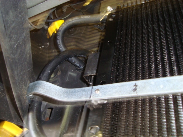

Got the trans cooler in the cuda today and ran the rubber trans hoses. Had to make some large holes in the radiator support to pass the hoses to the rear of the radiator (with rubber grommets). I plugged them on the backside until I install the 2004R. Also wrapped and tied down the safety neutral and back up light wires. I also took some pics of the mag truck 2 1/4" exhaust manifold as it passes the torsion bar/oil filter area (in case anyone is interested).

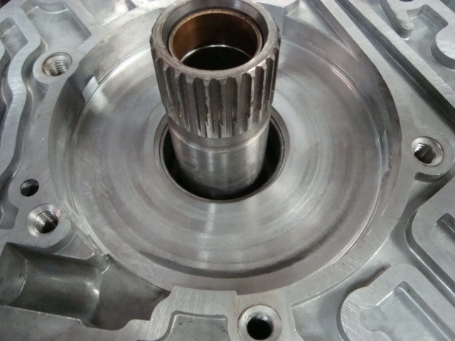

Finally received the Hardened Pump stator support. Now I have to wait for all the other stuff. I think I've decided to go with the 1600-1800 GN torque converter , non luck up with brazed fins. I don't plan on doing any racing just the occasional ROMP in the street.

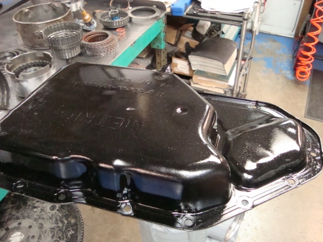

Man these guys don't fool around. They're following my instructions to the letter on this tranny. They've tore it down, found all the weak/worn parts, replaced every single bushing (very important), replaced clutches and steels, tossed out the old pump body (it was still usable but it had minor scoring...SEE PICS), they are using the shift kit instruction sheet to make all the modifications to improve shifting and fluid pressures, new ten vane pump, replacing servos with HD ones, valve body mods, installing non lock up kit , they're even drilling the 1/4" hole in the front pump drain to improve flow. It's looking great!!!!

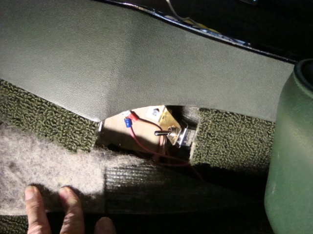

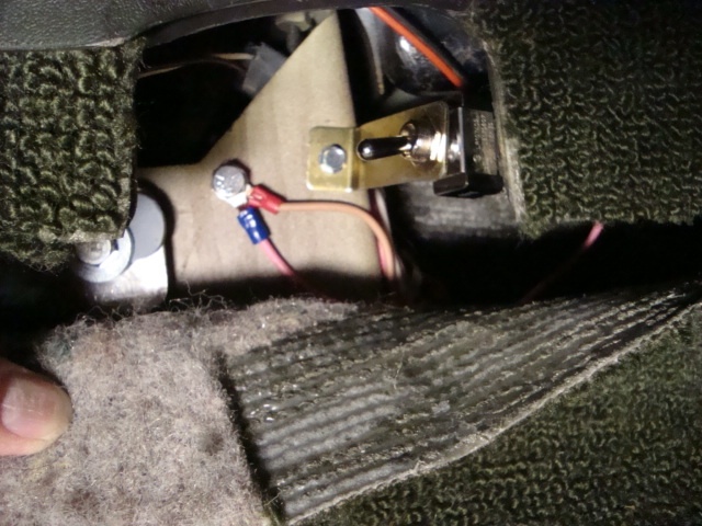

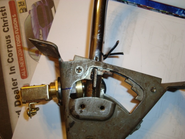

OOOPS!! I accidently started a new thread to show my back up safety switch. I meant to put it here. Don't know how to delete a thread.
treblig
