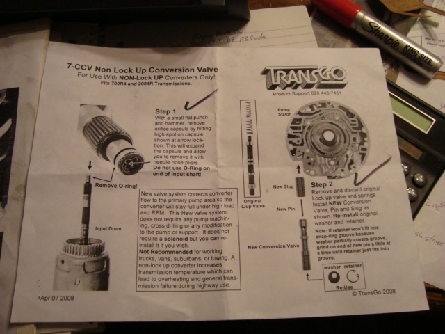

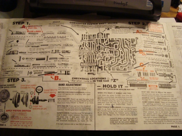

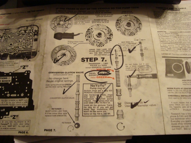

Well finally some progress. Here are some pics of the SysKoKit (Shift kit,SK200-4R-B) used on my 2004R and the Transgo non lock up kit and the Gil Younger Reverse fix. The guys at TransPartsWarehouse checked off everything they did (on this work sheet) as they overhauled the 2004R. Then they put it on their half million dollar dyno and tested it to make sure everything worked properly. I really like the fact that they have already ran the tranny (under load) to ensure everything works properly, all the pressures are correct and that it shift as advertised. I should be able to pick the tranny up in a few days. Too many mods to list but you can see in the pics all the things they did. Will list all the new parts installed in a few days.
PS - I'm running out of excuses and will soon install the 2004R in my '69 'Cuda.

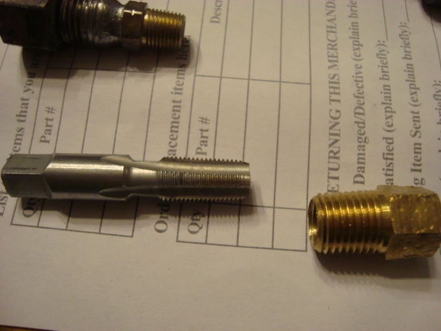

After thinking about the 2004R swap I didn't want to use the GM trans cooler lines then downsize to the mopar fittings, The mopar fittings are 1/8" pipe in the transmission and in the radiator. To make things worse the mopar fittings have a much smaller opening than the GM fittings/line. Here you see the Mopar trans/radiator fittings: First Pic....
Then we have the GM tranny fitting...second pic
You can not adapt the GM fitting to the Mopar fitting unless you use about 3 or 4 adapters which makes the cooler lines look bulky and awkward. I went to a specialty shop that sells every type of fitting and adapter and they still had to use three additional adapters to make it work. So I got mad and decided to cheat!!! I am a machinist and after thinking about it for a while I checked the size of a 1/8" pipe tap drill. Then I checked the size of the other end of the GM fitting. I came to the conclusion that I could drill and tap one end of the GM fitting to make it connect to the 1/8" pipe fitting. The male to male 1/8" pipe ID is almost as large as the GM tranny line where the Mopar 1/8" pipe fitting is much smaller (don't ask me why??) see pic Number 3, Mopar on right. The 2004r requires more fluid transfer to keep the fluid cool so I didn't want to restrict the flow with the smaller Mopar fittings/line. I used my 1/8" pipe tap to make threads inside the GM fitting (pics 4 and 5). After I threaded the GM fitting and screwed and tightened the 1/8" pipe (male to male) into the Gm fitting (pics 6 and 7), I took them to my radiator man and had him silver solder the connection to guarantee they would never leak. It only cost 10 bucks to make the special fitting. Now all I need to do is screw the 1/8" pipe into my Mopar radiator and attach the GM line (second to last pic) This same GM line screws directly into the GM tranny fitting which offers a larger 5/16" line (pic 9) and more flow to keep your tranny cool.
I had struggled with this problem for a long time because I didn't want to use all the adapters to make it work and still have the restrictive Mopar fittings in the lines. I also didn't want all those bulky adapters sticking all over the place. This way it makes it simple, I screw my adapter into the radiator and use the GM lines from the tranny to the radiator, then to the trans cooler, then back to the tranny. More flow, cooler trans fluid and cleaner install!!!!
Treblig

I still haven't had the chance to install the trans even though I have everything I need to make the change. The torque converter is a non lock for a very good reason....both the 2004R and the 700R4 use the factory lock up torque converter that "kicks in" after the tranny is in forth gear. Unfortunately the method used to lock up the torque converter is hydraulic. In other words when the torque converter locks up it steals hydraulic pressure from the system which robs pressure from the forth gear lock up pressure. In these overdrive transmissions forth gear is usually the first thing that fails. Once forth gear clutches begin to fail they flood the tranny with trash (metal/fibers). It all down hill after that !!!! One reason for forth gear failure that it is the weakest gear and the other reason is the fact that the converter steals pressure from the system to engage the converter lock up. By using a non lock up converter you take away one factor which causes forth gear to fail and increases the likelihood of a long lived transmission. BOY!!!! That was a mouthful!!
PS - If you decide to use a non lock up converter be sure to also use the biggest trans oil cooler you can get in your grill. Non lock converters produce more heat (the higher the stall the more heat you get). This is one reason I didn't want a high stall non lock up converter for street use. It's really not that big a deal since cars ran with no lock up converter for many years with the standard radiator trans cooler and they lasted many, many miles before failure. But if you have a strong motor and a non lock up converter it doesn't hurt to have a little insurance (Big trans cooler) in addition to the radiator cooler!!
