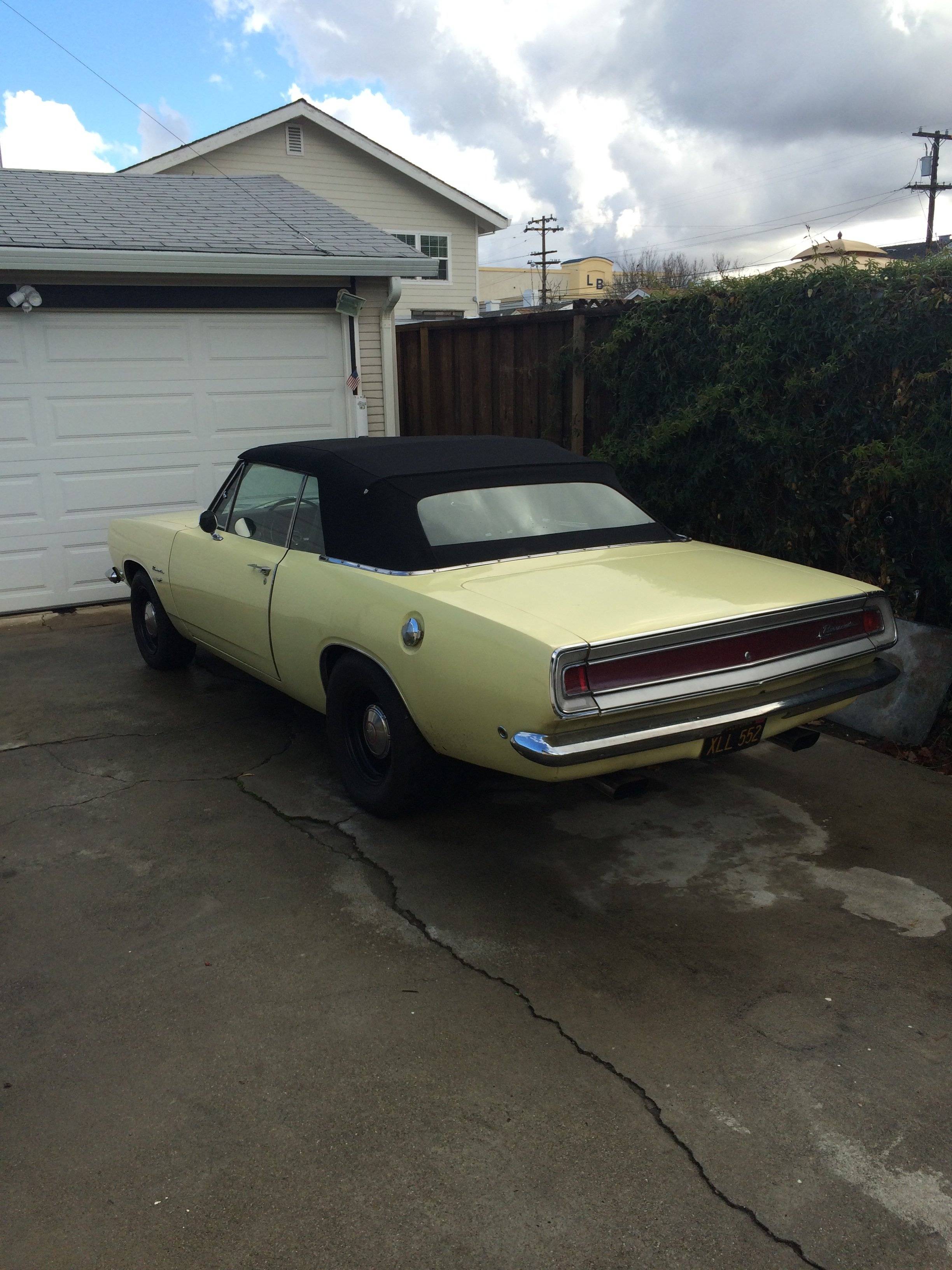

I've washed my '68 with Comet in the green can for the last 15 years. It says right on the can, will not scratch delicate surfaces.
Do it on a small lower panel using a wet terry cloth hand towel in the shade. Sprinkle some cleaner on the wet clothes and use small circular motions. Rinse well while wiping off the surface with your hand.
Dry it and see what you think. It's nothing short of amazing on light colored cars. I use it on chrome, glass, rubber and plastic. Never had an issue. It will look like someone spent a week buffing and polishing your car.
Once you are done, add an ounce of kerosine to a few gallons of warm water, splash it all over the car and buff dry. The old in the kerosine will make water bead up, keep bugs and tar from sticking and make it shine like you spent another week waxing and protecting all the rubber and painted surfaces.
Takes about an hour to do the whole car. Been doing old light colored cars like,this for nearly 4 decades. Learned it from an retired Cadillac dealer. Don't use it on dark colored cars or in the sun.
