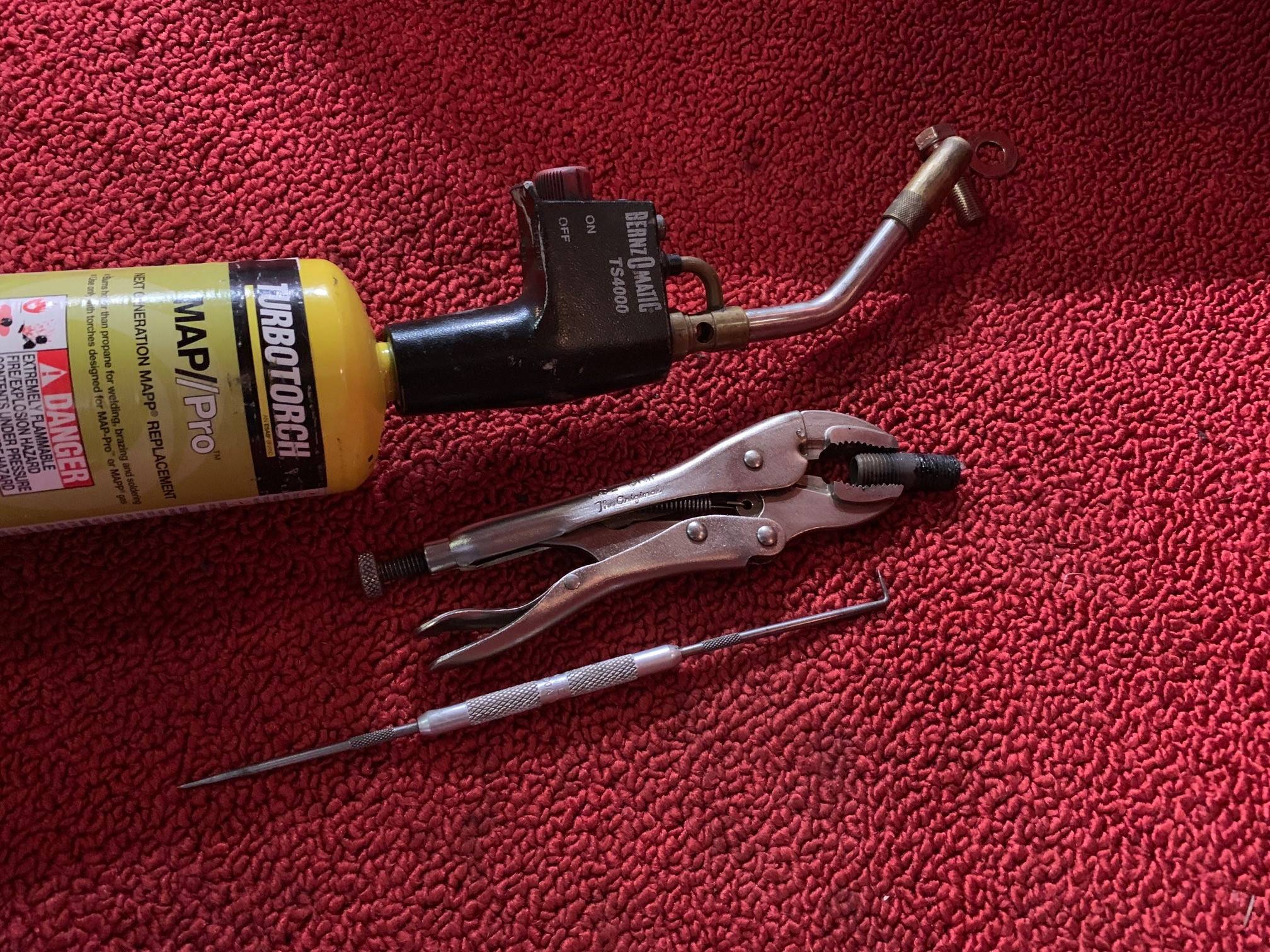

I use a small torch, a 1/4" pipe nipple from a hardware store, a pair of vice grips and a dental pick that unscrews. A long #8 nail or 1/8" rod will also work as long as one end is sharp. What ever you use make sure it slides easily thru the center of the pipe nipple.
