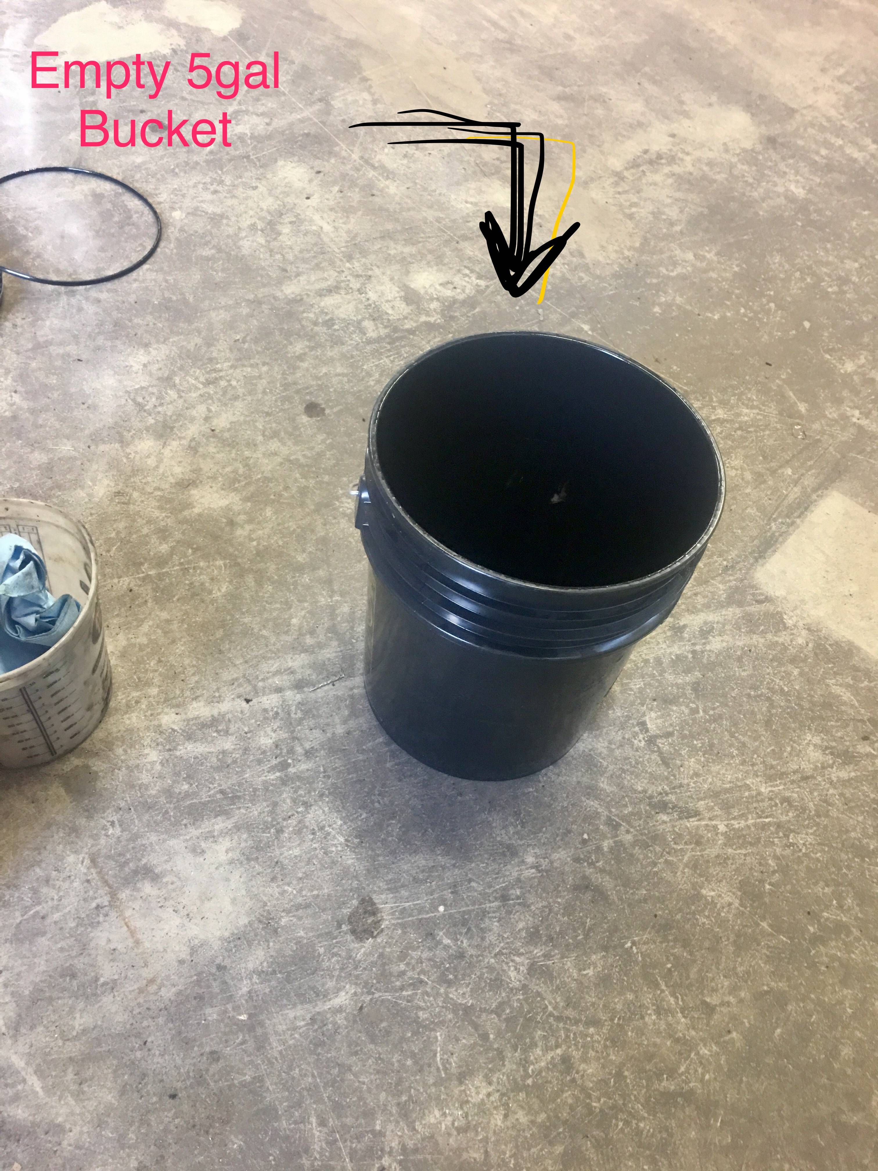

Take 2 empty 5 gals buckets and one cover.
cut the bottom of one of the bottoms minus 1/2"-3/4" to leave as a small lip
place one bucket with the cut bottom inside the whole bucket
This is my tool of choice for cutting out the bottom of the bucket- a 3" air "wizzer".
drop the center chuck in the top
bucket
attach the cover and label. All good. If you put lube in the bottom to coat the gears or completely dry. Also if you do fill with gear oil, make sure you use a cover with a seal and please lift the whole bucket by both handles and not just one as with the center chuck it will be HEAVY!
