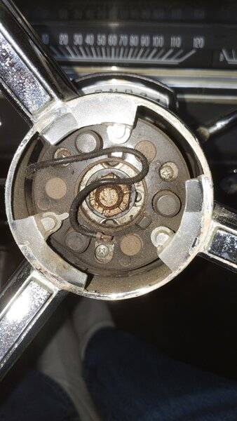

![026~2.jpg 026~2.jpg](https://www.forabodiesonly.com/mopar/data/attachments/1511/1511248-b7714289c28a8034d79a80259600d5aa.jpg)
Grab center medallion cap and twist counter clockwise while holding the horn ring and steering wheel from turning.
