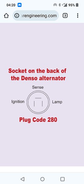

3 different plugs all of them take a 12 volt switched feed and have a combo of other connectors one of which will be battery sense the other may be idiot light or tacho or ECU control. check the labels
the easiest to use has 2 spade connectors in a T shaped plug 12v/ light or 12v/sense

wiring was easy.... https://arengineering.com/wp-content/uploads/ARE-AR022-proof.pdf
i used this alt. Denso 210-0106 (Napa 213-8283)
