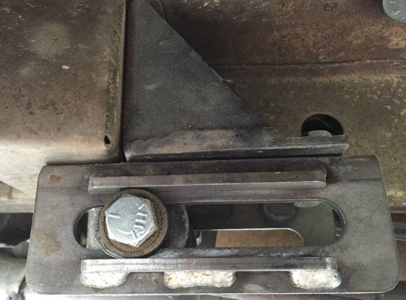

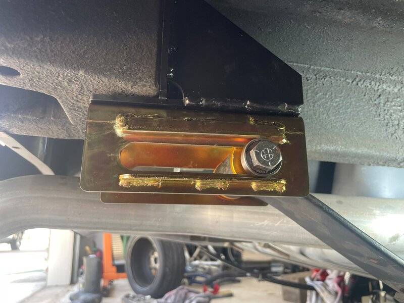

I finally got around to getting rid of those offset shackles. I swear I could almost feel them bending on turns. Hopefully this will give me some lateral stiffness. Note suspension is hanging, that's why the bearing is all the way toward the front. It should be around 75% toward the back with the weight of the car on it.

Hey those look kinda familiar!

nice things but i've always thought they'd be noisy. for me, i'd make up a panhard bar and poly bush the shackles (not 70's ones though, lol).

I’ve put sliders on my car almost 8 years ago now, I use the car as my daily most of the year. The sliders do “click” occasionally, but I almost never actually hear it over the exhaust and the stereo. So, they do make some noise, but, a lot of things on these cars make some noise and the noise from the sliders is occasional and not all that loud. So I very rarely ever notice it.
also and i forgot to mention there'll still be side to side axle movement due to flex in the leaf springs themselves. if handling is the goal either a panhard bar or watts link setup is best.

I'm not concerned about the noise and as @72bluNblu mentioned, it isn't anything to worry about. I had poly bushings. I'm sure they give a little, but I'm thinking the bend in the shackle itself is where the deflection comes from. They are just a piece of flat steel with 2 bends, they are already weak laterally by design. Tire rub is the tell tale sign that I'm getting movement, so I had to do something. Those shackles are fine for 95% of people out there. I just found their limit.
A panhard bar would be great, the problem is the pivot locations need to be in an exact spot to prevent suspension from binding up. Finding that spot would be next to impossible for me. Not to mention, I have full exhaust and stock type fuel tank. There's not a whole lot of room under there for more stuff.
@72bluNblu @racerjoe How much does the pinion angle change with sliders?
The way I did my car the change in height was less than 3/8” from just the slider swap over. Since it was all from the rear it would definitely tilt the yoke down a little more, but it would be a fairly minor effect. I honestly didn’t check it again after the slider install and didn’t have any vibration issues. Probably not the best way to have done it but that’s what I did.
My car has a B-body 8 3/4 in it though, which have their pads welded at a different angle than A’s did anyway. I checked it all and shimmed it to the correct angle when I did the T56 install, but that install obviously changed other variables too.
If you’re building brackets there’s no reason you couldn’t make them a bit taller to keep the rear eye of the spring in the same place with the slider install.

Thanks. I just corrected angle after redoing my TKO Crossmember so the exhaust would tuck tighter. I'll just check it again before and after and adjust.
