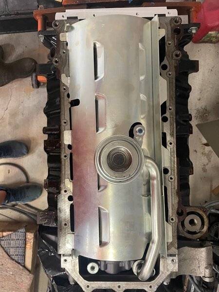

Finally feel like I'm making some forward progress with 5.7 engine assembly. The Holley cast pan is a quality piece, I was pretty impressed. The best thing about it, it went on without having to modify anything. I did have to procure the main cap stud that holds the pickup since I have an engine out of a car. My understanding the truck engines have this stud already. Fortunately my local dodge dealer had one in stock.
The power steering pump was pretty nasty from being bare aluminum, so I took it apart to bead blast the housing. While I was at it, I bought a rebuild kit from Rock Auto. Note that it is a "Toyoda" part and it is fairly known that the pressure output can be adjusted by getting the regulator valve from various Toyota cars. Rock Auto didn't show a rebuild kit under the charger section, but did under the Toyota section. For $10 I took my chances. All of the seals in the kit were a perfect match for the pump. I'll be hitting up my local junkyard to get the pressure valve out of a "Yoda".
I like the black pan. When I bought mine, Holley didn't offer them in black then.
At least it is easier to paint mine black than it would be for someone to strip a black one. :D
For whatever reason, it was about $50 cheaper than the bare cast. I figured I'd paint it orange until I saw it. I like the black.

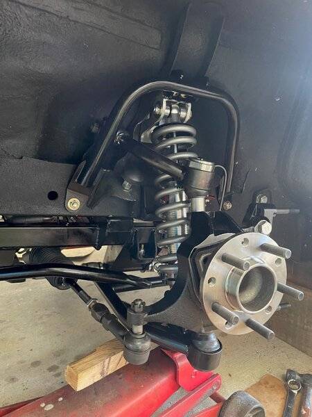

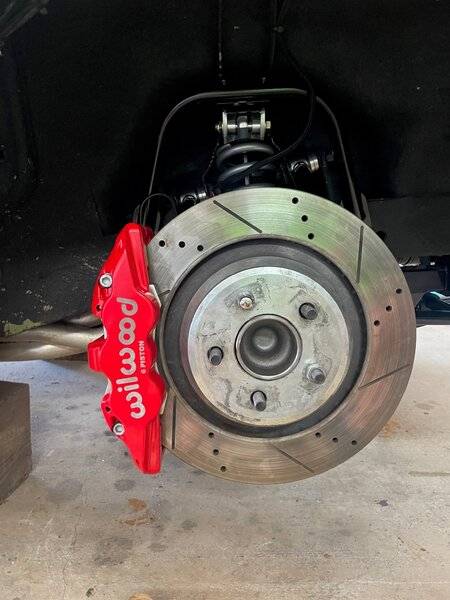

I did a thing, which may surprise a bunch of people.... My car is now setup with an HDK coil over K member.... you know, for science. Can it handle better than the stock K?
The stock K setup owes me nothing. It's done great and I likely didn't reach it's limit because I'm not a pro driver. Thanks to the help from people on this forum, I was able to source all the parts that can make a t-bar suspension work in ways the auto designers of the 60s could have never imagined.
I've read so many negative comments about coil over setups, but I can't create an opinion without experiencing it myself. So lets start with the 3 common items why people say coil over setups aren't good.
1.) The shock towers aren't meant to hold the weight of the car: Denny has addressed this with his hoops that connect the shock tower to the chassis. It's very robust. That $hit ain't going nowhere!
2.) Coil over setups don't have enough travel: Since Denny's kit uses the shock tower (with his special bracket for the coil over) the coil over I'm using is 16-7/8" at full extension, which is bump stop limited to 16.5". The stock shock is 15.5". The suspension travel distance between the stock setup and Denny's is very similar. I feel like the stock suspension can droop further and the HDK compresses further. I failed to measure the stock K before I took it apart. Other brand coil over setups do use a shorter shock so this statement won't apply to the others.
3.) Aftermarket Ks don't have enough camber gain: This statement is true. THe HDK does have less camber gain. However, is this even important? I don't know enough to see the benefits and hope someone can educate me. Here's the way I see it. Camber gain is the increase of camber as the suspension compresses. In a hard stop situation when the car nose dives, wouldn't I want to keep the tire as flat as possible? Camber gain would have a negative affect on this. I realize it may help in a turn, but that's where caster comes in. Why not set an aggressive caster so the tire tilts in on the turn when the body rolls. Again, I'm not an expert on this particular topic, so I don't know if it is good or bad.

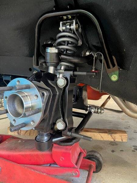

The spindle/hub assembly you see below is a drop in for the Mustang 2, but uses a C5/C6 corvette hub and brake configuration. I didn't have enough GM parts on my car, so I chose this over the standard M2 spindle. My wheels wouldn't work with the standard C5 brakes since the rotor and caliper are extremely close to the face of the hub. Converting to the radial mount Wilwood allows for lots of adjustment. I was able to shim the bracket very easily to accommodate the brake rotors I was previously using.
I'll elaborate more on this soon. I drove the car a few miles to check my home alignment and also let the springs settle so I can adjust ride height if needed. So far brakes are good, steering is a rack, so that's an obvious difference. More to come....

I've read so many negative comments about coil over setups...
I am certain I haven't read all the comments, but most of what I remember starts with "I have to have a COC to make my car handle" which usually devolves into the deficiencies of one or both systems.
I don't believe there is a perfect solution out there, my only gripe is the push by the aftermarket to make it seem like a $5k+ system is the only option.
It will be interesting to hear your back to back review on this. Far as I know, this will be the first one.
BTW, of all the COC options, I think HDK is the best of them. So good choice there.
I've often wished there was an option for a cartridge style wheel bearing setup for an A-Body. I should have guessed there was an option for the M2 spindles. At the same time, I wonder if it wasn't just a cost cutting solution for the OEM's and the stock setup is actually more robust. Doubt it matters, it's not like you see C5/6 Vette's littering the road courses missing a wheel because of a failure.
I know you were working on some of the issues with a G3 swap (oil filter and AC compressor clearance), is that part of why you made the jump?
There actually is an SKF hub that most guys that track their corvette upgrade to. Not sure if it's absolutely necessary but there is a market for it.

I do agree that people automatically turn to thinking its better. Maybe it is, maybe it isn't. I don't know of anyone that has done a comparison.
HDK has always been the kit that caught my attention since I'm not a fan of the short travel shock on the others.
The HDK will make the G3 installation a breeze. I could have made the other setup work, but sometimes, it's nice when things fall into place. I will say, the HDK went in without having to modify anything. It was a perfect fit. Oh, the weigh savings is incredible. I could carry that complete HDK in the picture above in one hand. I wouldn't even think of that with the stock K.

It looks like the lower shock mounts are pretty low on the LCA's too. I like that since it seems it would allow for a longer coilover shock and more suspension travel. When I converted mine with stock LCA's, I ended up raising the upper mount. In hind site, I should've thought about lowering the lower mount. I'll be curious what your takeaways from the swap are!
The amount of drop in the suspension travel on the HDK is limited buy the length of the UCAs, moving the ball joint(s) outward allows additional travel. It is a trade off, more travel or keeping the wheels / tires tucked in. I find 99% of HDK customers find 5 (plus) inches a good compromise. Of course with adjustable ends on both LCAs and UCAs, if more travel is needed, simply adjust the control arms outward.
While a big advantage of the HDK over the others is being able to utilize a longer travel shock while keeping your tires tucked. Also check out the hardware....grade 8 bolts, shocks that ride on shoulder of the bolt, not the threads, and let me mention over the counter (non modified) spindles utilizing automotive, greaseable / serviceable tie rod ends. BTW, one K fits all. Tim will breath a sigh of relief when he swaps to his Gen III, even the OEM A/C compressor will bolt right up.
HDKs lower OEM collapsible shaft replacement assembly with lower bearing makes swaps, installs, and removal a breeze
The HDK may not be for everyone, but it can be a nice option.
