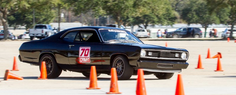

Everybody like pictures, right? While everyone up north is getting snowed in, this is prime racing season for us in the south. This was a couple weeks ago. I drove 80 miles one way to get there. I finished 1st in CAMT and 11th overall.
As you know, I'm done till March-ish. so time think about winter upgrades. Looks outstanding!
It was a slippery one this past weekend. The morning runs were on wet pavement and I just couldn't get it together in the afternoon. Oh well, I suppose everyone has an off day. I was quite frustrated and had to remind myself not to take this too seriously or it won't be fun anymore.
I love the action shots. I'm sure it's in here somewhere, but what are your front suspension mods? How do you get that stance?
It's an HDK setup with some changes/adjustments. Below is a link to a thread i started that quickly turned into garbage. If you skip all the bullshit in there, you might be able to find some good info.
DOES THE HDK SUSPENSION K-MEMBER HANDLE BETTER THAN A T-BAR SUSPENSION?
Alternatively, if you pay attention to some of the "bullshit" in there, you can get the same stance with a torsion bar set up. All the coil over conversions threads are the same, someone does a coil over conversion, claims they're dramatically better than the torsion bar suspension, and then don't actually prove that.
That said, @racerjoe has really put the time into tuning his HDK and is getting great results with what is definitely NOT an ootb HDK. He clearly has more time into it than anyone else I've ever seen with a coil over conversion and has the results now to back up his efforts. But if you put that kind of time into either suspension system you can get a suspension set up that will perform well. Pick your parts, pay you money, if you put the time into learning and tuning either system you can get a great handling car.
