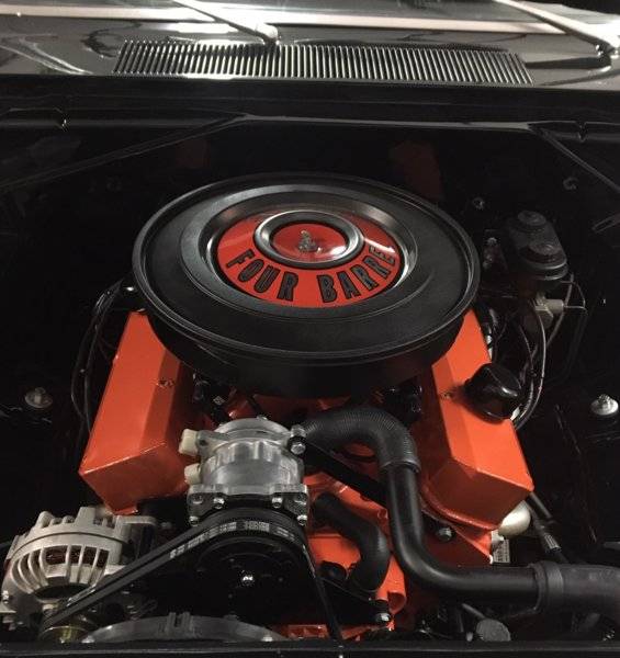

I had a bit of a valve train issue due to the pushrods being too long. Apparently oil wasn't getting into the cups and I ended up fracturing one of them. Fortunately nothing internal to the engine was damaged. Of course no one offered the length I needed so I had to make a set. All seems well now with the new ones. As you can see from previous pictures, I was running stock style valve covers. The problem with them is the only way they won't leak is to silicone them down. This isn't favorable when you want to keep an eye on valve lash. They were a major pain in the *** to remove, so I ended up buying the fabricated aluminum valve covers off ebay. They are of good quality, but bare aluminum doesn't fit the look I want. I painted them orange to help them blend in. I'm not thrilled with the look, but I'll take functionality over looks for now.

Here's a picture of the engine with the new valve covers. I think it looks like a big block Chevy now.....Oh well, they are sealed without the use of silicone so that's a win.

I'll get a better picture once I pull it out in the sun...if we ever get any around here!
