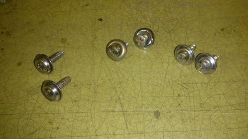

Before mounting the console in the car I found out I just have Three screws!!! I have searched these ones for years but they are hard to find. I'll see what I can do.

While working on the parking brake I was searching the screws that holds the console to the brackets. I have two of them. BUT, was there differencies between the front and rear screws on the console? Or was it two different styles, one front and one rear?
I first used the left ones but found more different screws that would work too!
Any input is very appriciated.

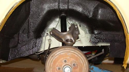

Tonight my friend Goran Nilsson from Liljaskolan showed up.Timeto get the undercoating done!
A lot of masking and tejping did it. Then Goran was set and done to shoot the undercoating. It turned out super great. Back with front shocks and now I'm ready to continue with the small stuff!
Thanks Goran!
