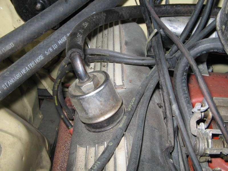

I have some questions regarding the 273 HP engine. My both DartChargers w/273 HP has CAP, Clean Air Package. It was required in the state of California. But it seems that the breather hose from the right side valve cover was connected on the backside of the carb. The air mixture screw was on the front side. Enclosed is some pictures on this. Can someone with orginal survivors verify this?
The PCV on the right side of the engine also had two different style of nut holding the valve together. It might have been different assembly lines or different manufacturers. But after checking out some pictures it seems that the LA produced cars had the bigger silver cad nut. Comments?
The oil filler cap had a breather hose on CAP equipped cars. It seems that the hose had a black phosphated band clips on each side even if mine just did on the engine side. The hose between theoil filler cap and the air cleaner has 5 grooves on the hose. Anyone having a nice used one for this?

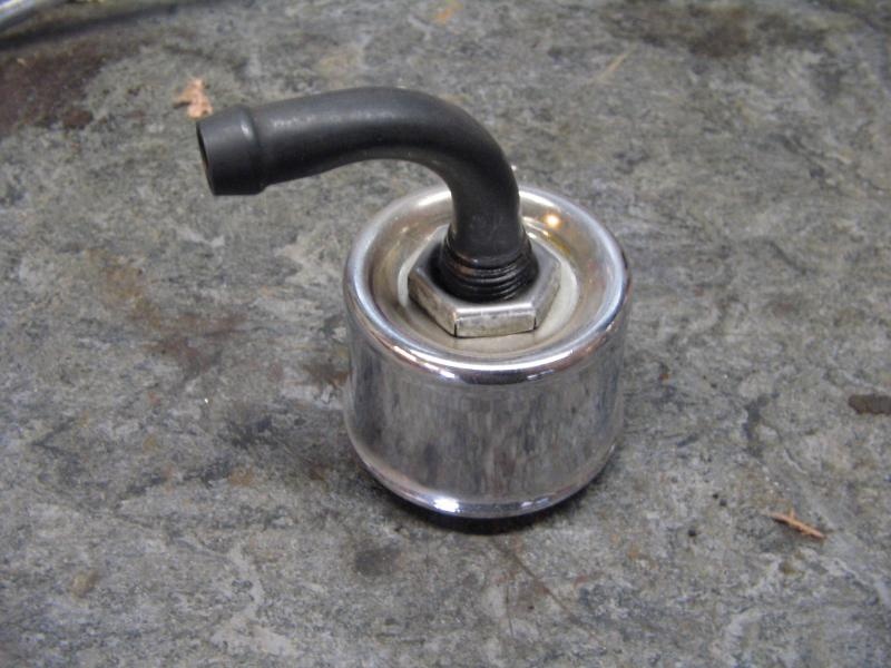

This PCV valve nut is wrong:
attachment.php
This PCV valve nut is right, but it's upside down:
attachment.php
Your '65 does not have the Clean Air Package. The CAP, which consists of modified carburetion and ignition systems, was first released on a small number of 1963-model test vehicles sold in California; see here. It wasn't present on any '64s or '65s, but was factory equipment on all new Chrysler Corp vehicles sold in California starting from the 1966 model year, and on all US-market Chrysler Corp vehicles starting from the 1968 model year.
What your car has is a ducted crankcase breather, which was on all California cars (from all makers) starting from 1964 model year, and all US-market cars starting from 1968. The only difference is the crankcase breather: open to atmosphere versus ducted to air cleaner. It gets a little confusing because "closed crankcase ventilation" was the term generically applied to a system with a ducted crankcase breather, but that same term, "closed crankcase ventilation", is what Chrysler called what we all generically know as "positive crankcase ventilation" -- that is, a PCV valve ducted to manifold vacuum, regardless of what type of crankcase breather is present.
Starter motor not-very-carefully painted all black is correct. Nothing wrong with date code, either. Remember, that starter 2095 150 was used on almost all 1964-5-6-7-8-9 Chrysler products. The only exceptions were 170 engines, taxi/fleet cars with heavy-duty 11" clutch, and some trucks. They made a lot of them at a time!

Thanks for the input slantsixdan! You rock! First of all, dids the PCV valve just had the small nut? I've seen the big nut on so many cars.
Why is thge hose connected on the backside if you had ducted crankcase breather? It seems that all those engines had the connection on the backside. I parted out a 65 Formula S with no ducted system. The connection on the frontside and the micture screw on the backside.

Ducting hoses: PCV valve to carburetor throttle body, always. Placement of PCV nipple on carburetor throttle body varies by carburetor make, model, and year. Crankcase breather to air cleaner, only on '64-up California, '68-up 50-state/Canada vehicles.
PCV valve nut: The correct stamped steel quick-nut wasn't an especially exotic hardware item, but not as common on this planet as an ordinary hex nut. All ordinary hex nuts look pretty much alike. It is entirely believable that Joe Greasemonkey down at the garage used a regular hex nut one day in 1972 because that's what fell to hand. It is also entirely believable, though I've never seen it, that one of the numerous companies selling OE (Stanadyne) or aftermarket metal '64-'69-type Chrysler PCV valves included a regular hex nut in the box with the valve.
