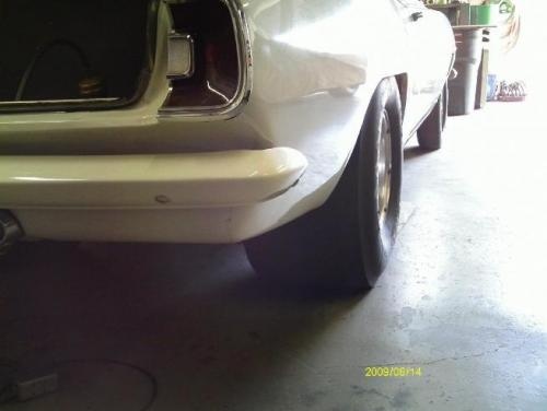

Have to come up with an idea for the rear bumper delete. Too close to the back of the shop to get a good perspective of the look now. Will take better look when away from the wall.
Maybe cut, narrow the rear bumper and weld directly to the body. Make it a little taller from top to bottom.
