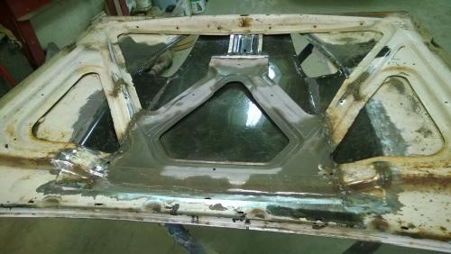

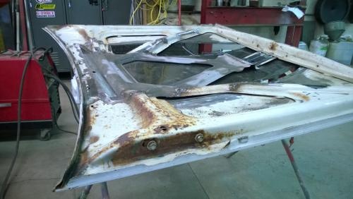

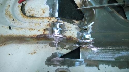

Got a couple of the sections of the hood brace welded up. Do some more tomorrow.
Feels good to be working on my car again. :cheers:

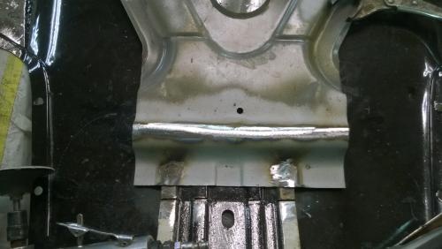

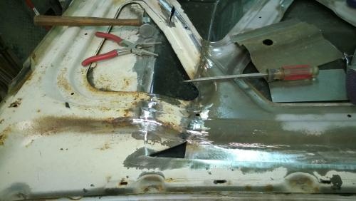

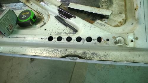

Got all the braces welded up. Some ground down. Still have a bunch to grind. This gives an idea of the outcome. I think I am going to drill a bunch of lightening holes in the support structure. Hood is going on a diet. :D
This top pic shows how they made it off center from the factory.

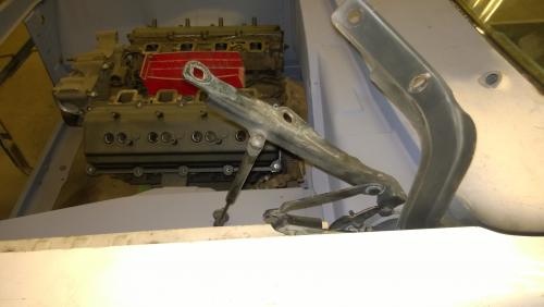

Then I was thinking about making these work with the hood. They're off the 300 parts donor.

The 300 hinges look a little spindlely for the weight of a old car metal hood?
I'd drill lots of holes.

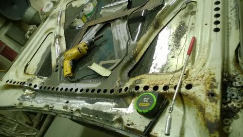

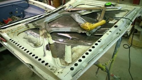

I am drilling holes for weight reduction. I will weigh the two hoods after weight reduction to see how much difference there is before trying to use the hinges from the 300. :D

I think I am going to do some hole drilling on the interior structure, etc. that you can't see or covered by panels. Maybe even some you can see. I'm on a mission. lol
The wife walked by the hood when I was drilling holes and asked me what I was doing. I said the car was going on a diet. She harrumphed me and made the comment that "it's only a little 5.7!" Like it's not gonna be fast and I'm wasting my time. The same engine in the 07 Magnum all wheel drive scoots really well for a 4800 lb car. I can visualize what this same engine will do in a car that weighs aprox 2k less than that.
It's gonna be a Hemi Cuda for crissakes.:burnout:
