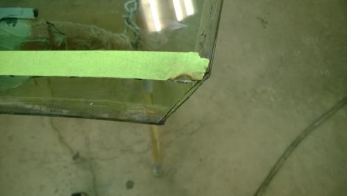

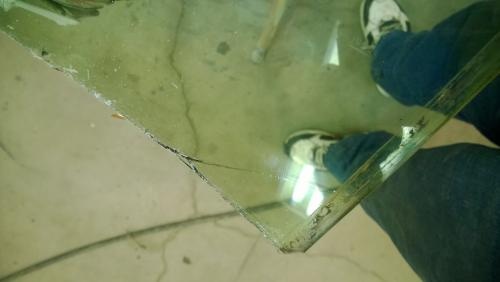

Well, I tried the windshield chop today. Was almost done and ended up with a crack on the corner. I figured out why after the fact. The top and bottom cut have to be right on top of each other. I had the bottom cut a 32nd too deep in the crack area and I'm sure that's the reason for it. Sat the windshield in the car and sized to two side pieces to fit. Now, just have to weld them in.

You did real good!! Most folks don't even get nearly that far before getting a crack. You almost made it all the way. At least you know exactly where you stand "size wise". Eat the cookie yourself to get some energy to do the next one.
You know, if the crack is only on one side you can get it repaired (or do it yourself) real cheap!!!
A clean crack like that will totally disappear once it's repaired.
treblig
