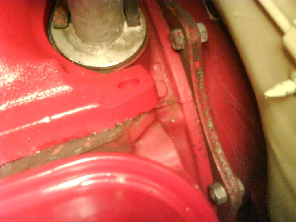

Yeah, I will have to wait and assess the body before I make any hard core decisions. I certainly want to bring it back- how many one owner 62Kmile cars are there anymore, let alone 340S 4speeds? If I can make it work, this is a total dream come true.
Looking at it yesterday the drivers side floor is shot, but the inside fender wells in the engine compartment were solid as were the strikers for the doors. The trunk was surprisingly decent.

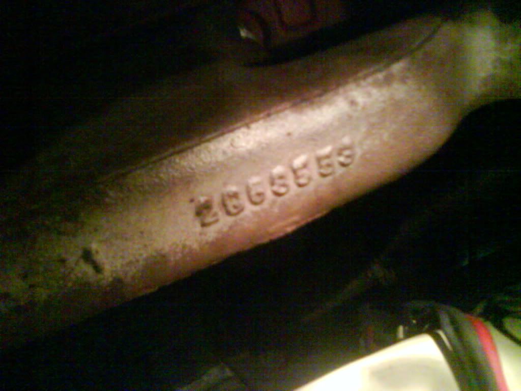

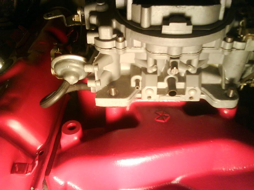

Your intake should be a 2531915 (this will be in the top behind the carb)
Your heads should be 2531894 (they may or may not have an x by the plug hole) If they do not have the X take off a valve cover and the casting # will be there.
It has the 340 exhaust manifolds.
The carb would be a Carter AVS with 4424s on the front lower left.
The block should be a 2780930 on the drivers side along with 340 cast into it.
My build date is 10-02-67 and my block is vin stamped on the top driver side bell housing flange. This will tell you if it is the original engine.
These are pics of casting numbers (some you can't read) and locations taken just now off my engine. Included is a clear pic of my early 68 "No X" x heads.
Sorry Im in the process of getting things test fit. Im pulling the engine for fresh bearings, paint and a smaller roller cam.
Very cool thanks for the pics. I thought the engine number was down low by the oil pan, but there are probably more than one. I did notice the manifolds are correct and the carb looks right but with some extra emissions stuff.
Very cool thanks for the pics. I thought the engine number was down low by the oil pan, but there are probably more than one. I did notice the manifolds are correct and the carb looks right but with some extra emissions stuff. Man, I wish I wasn't stuck at work.
It will be fun checking for #s. The block casting number is above the pan on the drivers side but the vin was stamped on the bell housing flange.
Great news! It is confirmed numbers matching on the engine! I was able to clean and read the last digits of the VIN so at least it is what I thought it was: a complete one owner Formula S 340 manual. I also like that it has the bench seat with manual brakes and steering- all go and no show!
The intake checked out as well. I have to do some work to ID the tranny, though.
