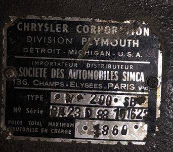

Here's the VIN on the dash, the VIN stamped on the passenger side fender (engine compartment) and the missing tag near the other two.
I've removed that last year, cause nothing was written on it anymore.

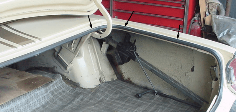

Where exactly can I find the VIN on the core support? Where exactly on the Trunk lip? I know both on driver side, but where? Pics appreciated :-)
Look somewhere on the lip that forms the drain and holds the seal.
core support?

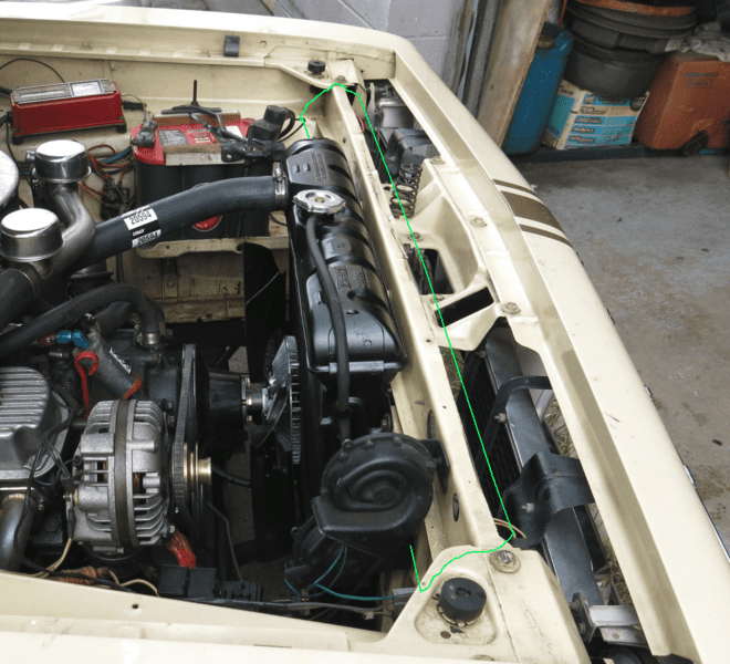

Interesting items
A. the alternator has a capacitor on the exterior. I assume that's on the field terminal?
B. Washer fluid tank is fully on top of the fender.
C. Master cylinder for drum brakes. Is it a drum brake car?
I ask because my impression was all of the US export RH drive cars got front disks.
I'd expect the same for the Swiss built cars.
Interesting items
A. I don't know...
B. Yes, it is, I don't know if it's the original... looks old for sure.
C. I have Front Disc Brakes, Rear Drums.
Do I have to remove the seal or is it visible without removing it? Thanks!
I dont recall. Someone here will know if its under the seal in '68.
'67 (mine) its the order number or something like that so is a little different at least in that regard.
A. I don't know...
Connections are like this.
Be careful with Power Out. That circuit is connected to the battery positive. It is energized at all times! You may find a plastic protector over it. A safety measure installed by the factory to reduce the chance of accidental grounding.
Marvin will probably know.
Someone probably replaced the master cylinder.
The disc brake version has a larger reservoir for the calipers. Unfortunately they have become somewhat scarce so parts store suppliers often substitute a drum brake version with the residual valve removed. It works but requires more frequent checking of fluid level.
Not original....most US cars in Europe got over their lifespan 'wrong' spare parts, the mechanics had often to 'improvise', because there existed - especially in the 8os and 90s - definitely no supply with original spare parts. This explains the Pontiac seats also....

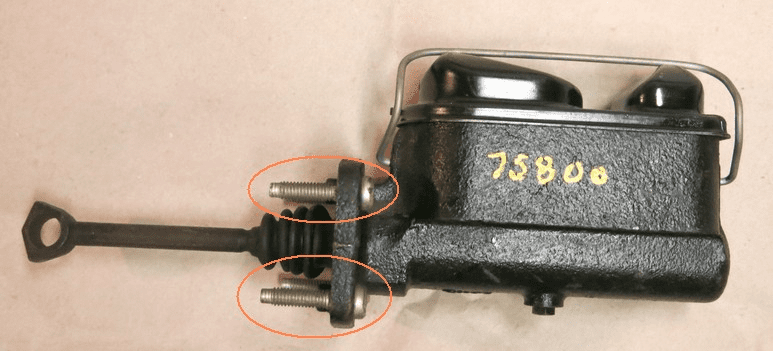

They sell on ebay under the name old.parts Here's the ebay link NOS Brake Master Cylinder 70 Plymouth Duster w/ Front Disc Brakes 1970 | eBay
What they are selling is the same casting, bore, piston, etc and is probably old stock Bendix replacement.
The original part number, at least for US/Canada, was p/n 2808600 for 1967 - 70.
Same master cylinder used for power and manual disk brakes those years.
The casting number for that MC will be 2225541.
There may be a faint A stamped in the front of the cast.
This replacement does not.
It also comes with studs installed. I can't recall if they are used with the booster. Its been a long time since I had the booster on a car. They're not used for manual brakes so I pressed them out.
