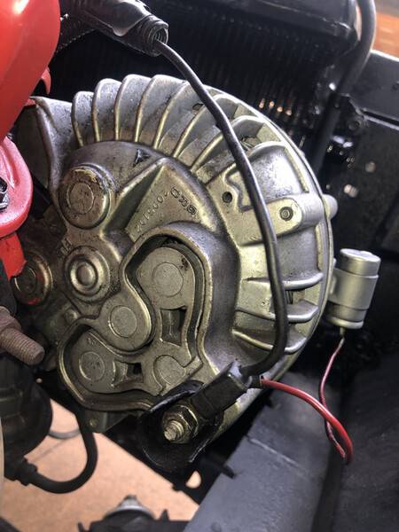

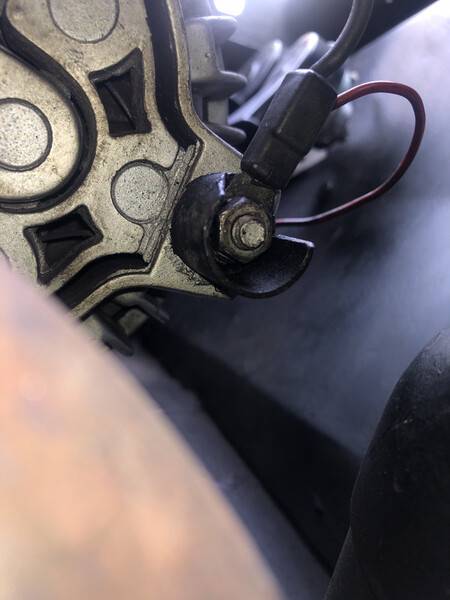

Connections are like this.
Be careful with Power Out. That circuit is connected to the battery positive. It is energized at all times! You may find a plastic protector over it. A safety measure installed by the factory to reduce the chance of accidental grounding.
Marvin will probably know.
hi, the capacitor is wired like this:

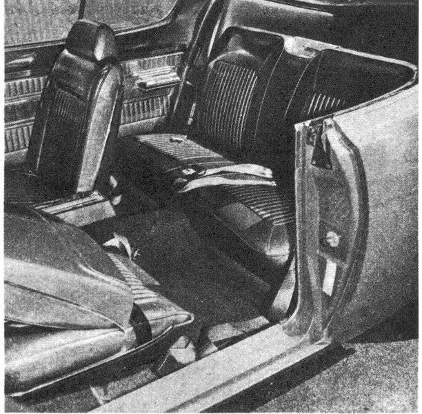

FWIW the '67 RHD export photographed in this magazine shows headrests.
Very rare option for '67, at least for North America.
The '68 campaigned by Chrysler France has them as well. But that does not prove it was a standard on exports.
On the alternator; the capacitor is on the output terminal.
Maybe a repair ? or maybe a version I'm not familair with.
A small mystery but nothing to worry about AFAIK

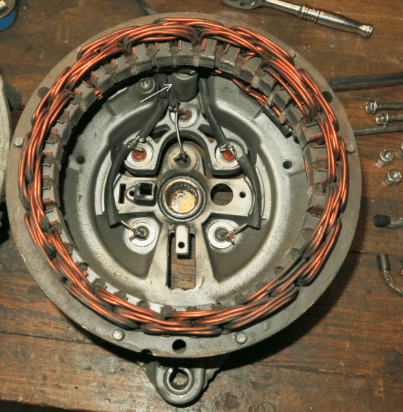

Normally the Chrysler alternators we see have a capacitor connected to the output stud on the inside of the case.
Specifically in that alternator design the capacitor is integral with the output stud.

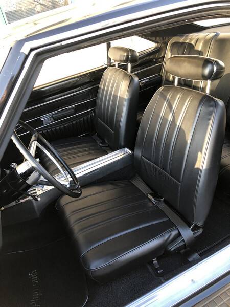

The seats from Nevada arrived on Wednesday (thanks to New Fish) and Legendary Covers + Foam arrived the same day. It's been a hard job... but very satisfying.
