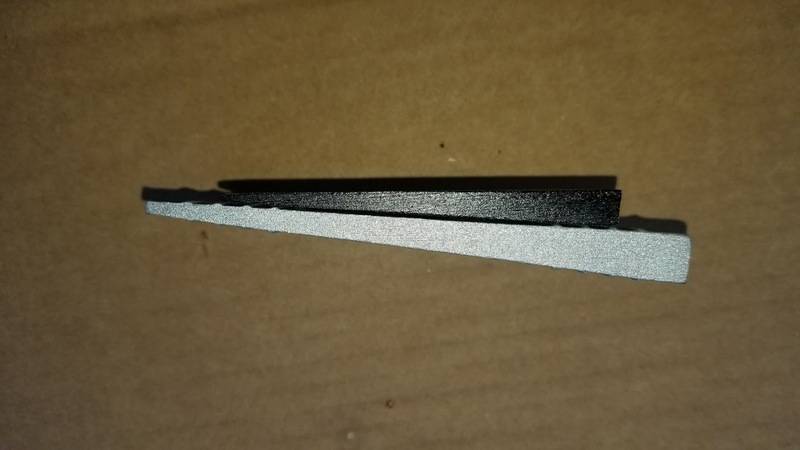

Wedge shaped Shim I made for the driver's side. Helped with a little more header to steering box clearance.
It's a tight fit for sure, but the TTi mounts work with my TTi Headers and Mopar Manual steering box.
The before and after shim... modified/repurposed rear end shim from an off-road shop. Came in a pair.
Cut one down, sanded and painted.

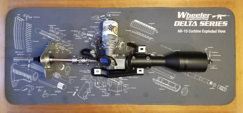

Electric power steering from EPAS performance with a modified Ididit tilt steering column helps reduce clutter in the engine compartment. Eliminates; PS Pump, Brackets, Reservoir, Belt, Hoses, Fluid, constant parasitic HP drain on the engine. Motor is inside, under the dash. Probably save a little weight too.
My complete EPAS Column. Electronic control box not shown. Input/output sensors manage the amount of assist in real time as needed. User adjustable for more or less to suit.
Also clears my TTi headers and 6.1 valve covers. Stock column, stock steering coupler would not.
Solves multiple challenges. Collapsible too to maintain a margin of safety. 3/4" DD lower shaft into the 1" DD upper shaft. I added the upper U-joint just in case, for mounting flexibility. May not have needed it...
I also made my own firewall mounting plate with bearing.

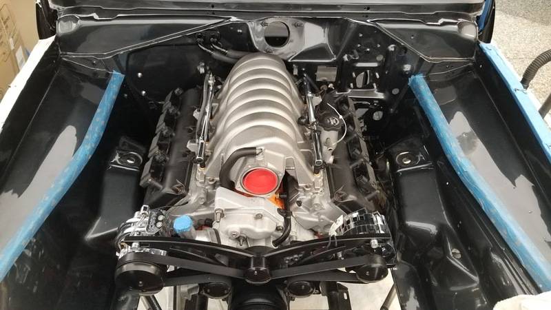

With only an AC compressor and alternator front accessories, I chose March Performance Serpentine kit.
It solved my AC compressor location and I really like how it looks. I modified it and routed the belts to my liking. Don't know if March has a system for Hellcat motors...

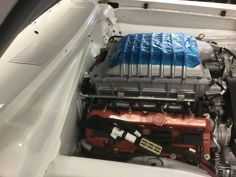

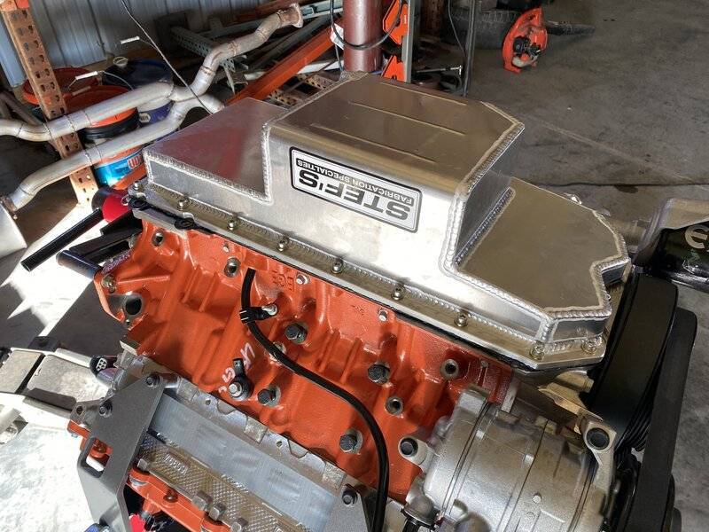

Note that is erict's thread and he used an aftermarket intercooler manifold so it doesn't look like he had to cut the firewall, although he did say everything had to come off the firewall. Not sure about his motor location either since he has an HDK kit.
In addition, MMX built a Dart with an HC, and best I can tell didn't mess with the firewall and uses the OEM FEAD. So maybe it works? No idea what motor mounts or anything for their build.
MMX's Hellcat Powered 1971 Dodge Dart Build for HOT ROD 2021 Drag Week by Modern Muscle Xtreme
Here is a build using a QA1 k-frame (I think) and a Hotchkis TVS system - 68 Valiant Hellcat Swap
I suspect an aftermarket intercooler manifold would have made those cuts smaller.
Love that solution, and one I had forgotten about. I had planned do do that exactly thing at some point, but ended up going with a Borgeson due to a coupon and the fact that it was quicker to do. My car was originally a manual box car and it kind of hurt to put PS on it, but it sure was is nicer to drive.
Great solution for the low mount AC compressor interference with the stock motor mount location. Holley has a similar one, but they use their own TC cover and water pump casting which probably drives the cost up quickly ($3K+).

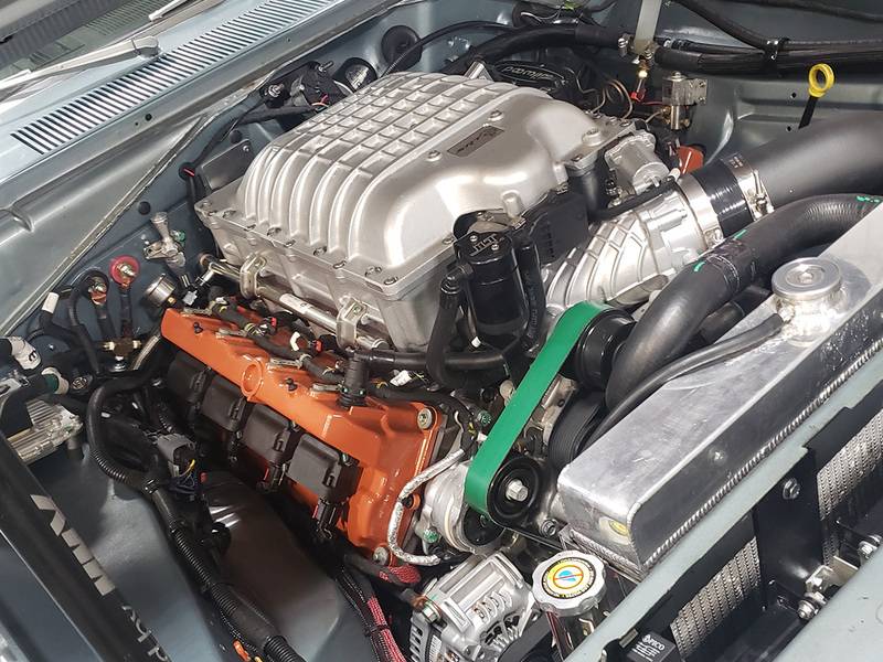

Found another post about using an aftermarket intercooler manifold saving cutting the firewall.
And this pictures leads me to believe that moving the engine forward 1.75" shouldn't be a problem. But it's still just a guess on my part.
