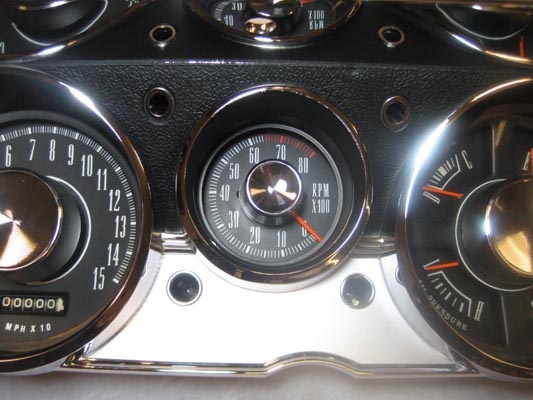

I sent a stock Barracuda 120mph gauge cluster with the center gauge blank to Redline Gauge Works.
What they did:
Converted the speedometer to 150mph using factory style stencil
Put a SW tachometer inside the blank, stenciled the range and redline per my preference with stock style lettering
Replaced the fuel gauge with a 0-90ohm unit to work with my fuel tank
Converted the anmeter to a voltmeter (left the face the same)
Converted IVR to solid state
Calibrated all gauges
All new bulbs / holders
Cleaned, painted, detailed

Looks great! Question though....I've been thinking bout this for a while...the speedo, converted from 120 to 150, how does it stay accurate for 150??
"Velocimeter" - sounds so much cooler. Why did they change it?
They use an electromagnet to adjust the field strength of the magnet inside the housing to display the proper range.
Read the section titled "Eddy Current": http://en.wikipedia.org/wiki/Speedometer
Velocimeter does sound much cooler! So Redline Gauge Works changed the magnet in it then??
They "adjusted" the field strength of the existing magnet thus calibrating it to read correctly with the 150mph face.
Gotcha...what about prices??
All in w/ a new speedo cable was about 1k. Pricey, but compared to new gauges and a custom dash it may be cheaper this way. Conceptually I wanted functional gauges, etc. but with a stock look. I also went through two Autometer 5" speedometers in the period of about ten years in an Aluminum dash I fabricated in 1991. I have never had an issue with the stock stuff, so I finally decided to go this route. The effect I want when the car is done is for someone looking at it from the outside or the passenger seat not to know that the car is much more than stock.
If you want I can PM you w/ line item details on the cost.
COuld you PM the Cost break down if you still have it or recall it? Thanks!
Repair speedo, reface w/ 150mph stencil, recalibrate: $180
Convert Blank to 8,000 rpm tach: $225
Convert Amp Gauge to Voltmeter: $160
Convert Fuel Gauge to modern internal & 0-90 Ohms: $160
Voltage Stabilizer Conversion: $65
Detail Cluster: $150
Bulbs: $1
Bulb Sockets: $2
New cable w/ vinyl coated steel housing: $50
Calibrate gauges: $35
