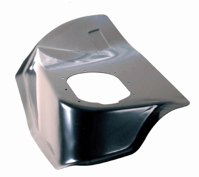

You have to weld in a 4-speed tunnel which is available from AMD.

Don't mean to through you under the bus Pntastar69. Your photo was handy.
