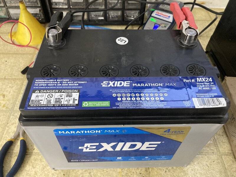

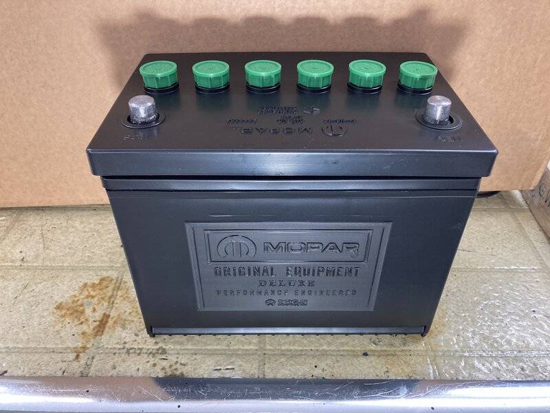

My fake Mopar green top battery. Actually an Exide MX24 AGM battery
Yes, that is a stick on decal. Smaller than the original script, so not quite correct. I spray painted the exide battery case black. I got it from Weskcar on e-Bay.

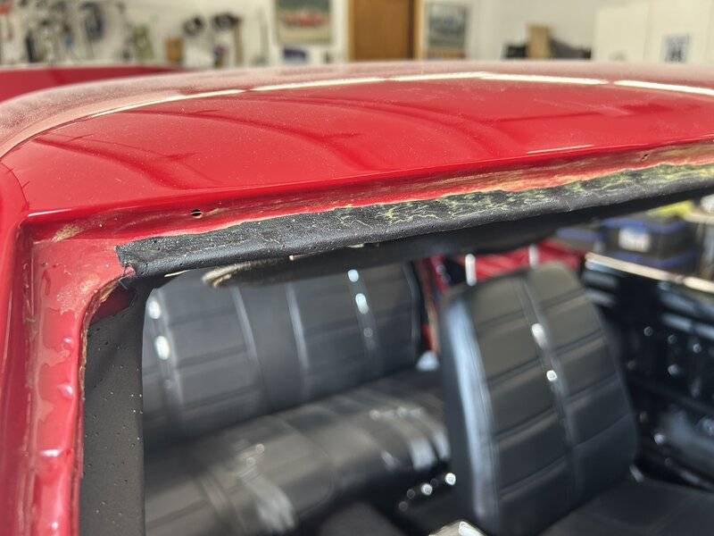

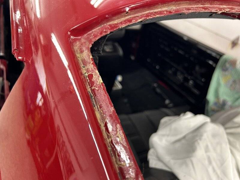

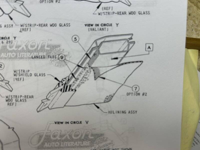

Had the headliner installed, but does not appear correct at the windshield gasket pinch areas. From my recollection of the original and factory drawing, it should not wrap around the pinch weld.
Back at the Cuda after a long delay due to family member health issues.
A heat gun and a new (i.e. sharp) razor should take car of that. Hopefully it's secured well on the inside.
Pretty sure you are correct.
The headliner is stretched and held by the lanced tabs piercing the headliner material.
Thanks guys. The After looking closely at the factory drawing and install instructions, it shows it secured by the barbs, plus it is glued along the frame where the barbs are located. Will have to peel it off and fix it on both front and rear windows. Mumble
Whoever installed it may have glued it there too. You may luck out. Either way, it shouldn't be too much work to remedy. Good luck!
