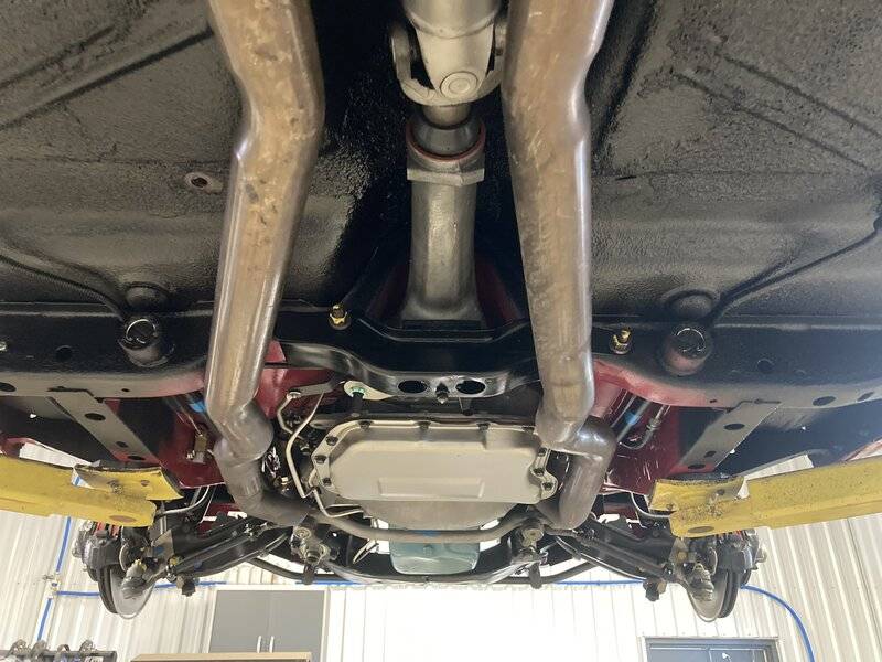

Rear end, exhaust and drive shaft installed and back on all 4 wheels.

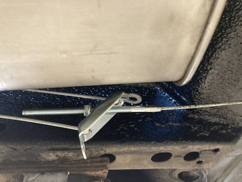

Another problem with emergency brake cables. One is too long (or one too short). New reproduction parts from Right Stuff but not always right. More gnashing of teeth!!
One brake cable, try sending them above picture and tell them you want correct length. I'd think if they're reputable they'd at minimum reply and attempt to resolve.

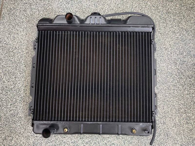

Ready to install my original rad. Was restored by Glen Ray, who do excellent work. Supposed to be fairly rare 3 core rad.

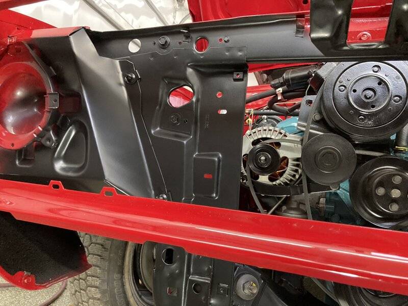

Finally got the AC/Heater box installed. It is a heavy awkward thing to wrestle into position!!! Also installed the wiper linkage.
