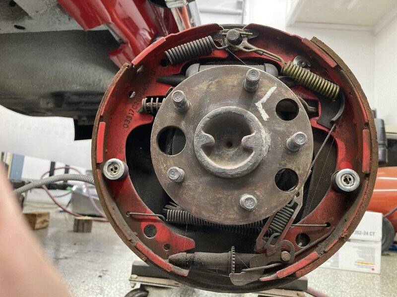

Brake linings were found with some cracks. New ones on order from RockAuto

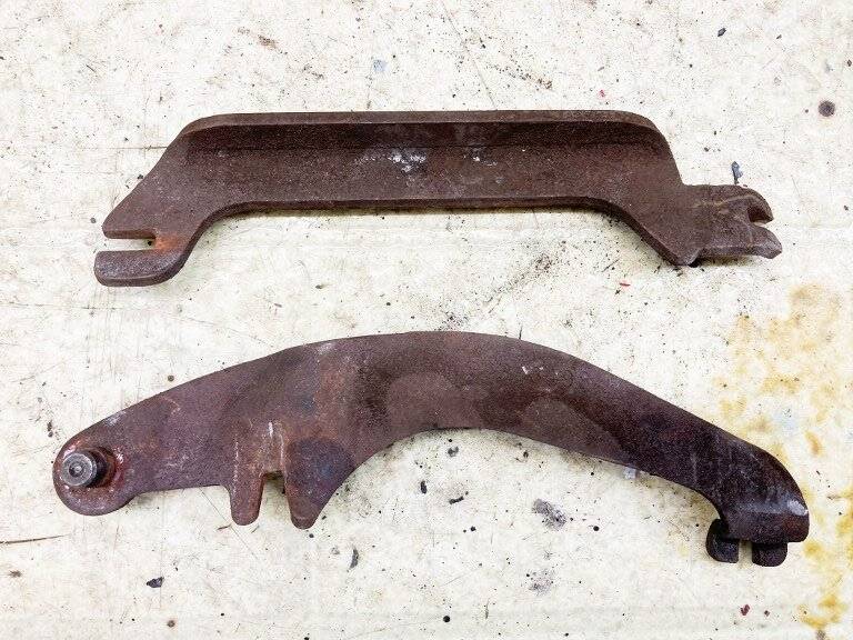

Cleaned up a few rusted brake parts
My usual process for plain steel parts is glass bead blast, derust with Evaporust, self etch primer, Seymour stainless steel paint and in some cases a few coats of Eastwood Diamond Clear.

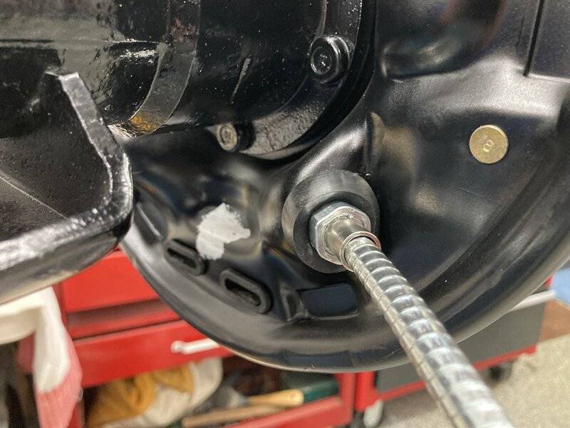

Man I hate aftermarket parts!!!! The spring on the end of the emergency brake cable was too long and could not get it assembled. Fortunately I kept the old one and the spring on the end was a lot shorter!!! After cutting the spring shorter , it all goes together with no problem!!! Right Stuff RSBCY03
