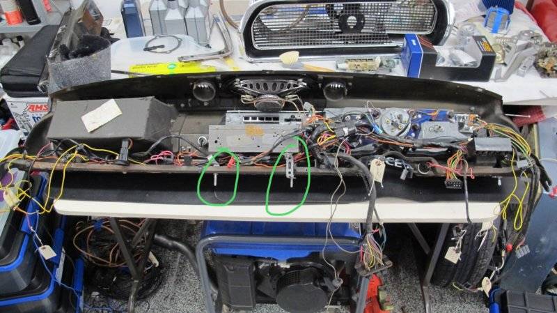

Nice, A01 and N85 tach. What was mounted below the radio?
The heater/air conditioning/fan module
I meant on the studs below the dash frame under the radio area. CB or 8 track maybe?
My 68 notch looked like that setup but seem to remember it was directley attached to the dash frame.
These are what I am curious about.
