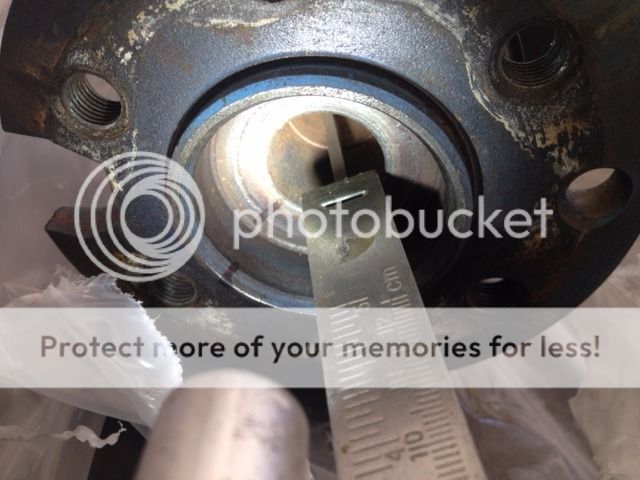

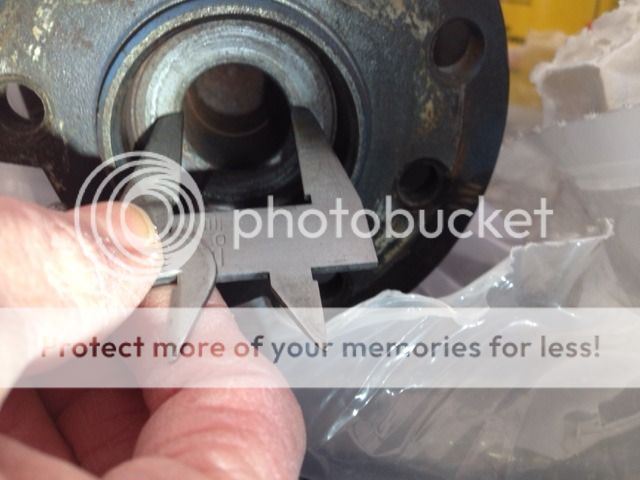

I prefer the bushing if the crank is drilled for it. But if it isn't drilled the bearing that slides into the torque converter register will do just fine. If your crank isn't drilled deep enough you will have to cut an inch or so off the input shaft.
Underneath, the crank needs a pilot bushing installed to run a four-speed. Unfortunately, not all Mopar cranks were drilled or finish sized for the bushing. Cranks that are drilled, but not finish sized, will work if the O.D. of the bushing is turned down, or often with a NAPA 615-1033 undersize bushing made for unfinished cranks. Undrilled cranks can use the later Mopar bearing 53009180 which fits in the cranks torque converter hub register, though the nose of the trans input shaft will need to be hacked off for clearance. Luckily, the Darts 84 police 318s crank was drilled and sized for the regular pilot bushing. Knock it in with a proper driver.
I don't think that is deep enough for the input shaft. Best I remember that hole for manual trans crank is over 2" deep when drilled from the factory. I can check one of my 340 cranks this evening for a more accurate depth of you need it.
It would be greatly appreciated. Also note that it was measured from the top of the hole. Not the hub flange.
I measured 1.964" from the flat surface where the pilot bushing goes to the fartherest point back in the center of the hole.
1.964 is the depth of 360dusters crank, not exactly how deep yours needs to be. I think U are good. If U want grind 1/16" off the tip off the input shaft
