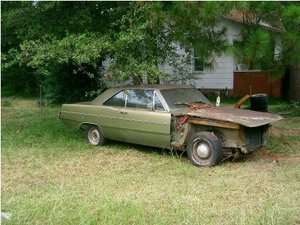

We bought her for $400.00 in Seattle, WA. She had no reverse and a busted ring. The journey begins.
I stuck a spare 904 in her to get her drivable for my Wife (I had my 1972 Dart Swinger Slant 6 4 speed). You only noticed the busted Ring (SMOKE.... ON) briefly every now and again.

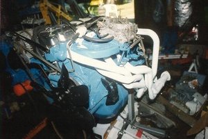

Here is the story on the Engine & Tranny replacement.
I had been hauling around this Slant 6 since 1989. I bought it from a dealership in Clearwater, FL. The story from them was that it was a 1964 (it was) 225 Slant 6 300 hp that was built by Chrysler in 1965 for a Mopar sponsored race car of some sort. The race team never picked it up and into the back room it went. I found it during an open house during a car show at the dealership wrapped in plastic on a pallet in the back room. I offered them $400.00 for all (Also on the pallet was the Clifford 4 bbl Intake and Headers) and they took it!
Now the bad news; When I went to put it in the 1970 GT I learned about the different Tranny/Crank Pilot sizes on 1964 Motors! This would have made no difference with a 4 speed Tranny. However, as my Wife could not drive a Manual/Stick It could not be used. I then sold it for what I paid for it.
(Note: Per the new owner of the Motor - FAST as Hell!)

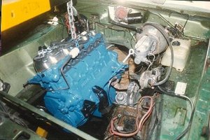

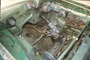

Then the clean up and Install Motor & Tranny.

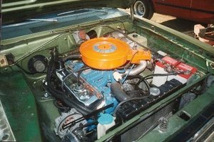

These are the Motor & Tranny in her to this day.
The sharp eyed among you will have noticed the addition of a few items in the Engine Bay pics:
I installed Power Brakes, Cruise Control, 7 Blade Fan, A Moparformance Chrome Valve Cover Set, & a Super Six 2 bbl set up.

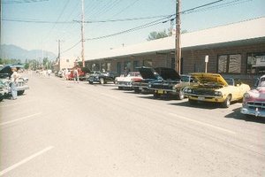

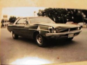

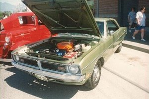

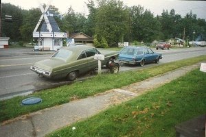

Her 1st car show was The Sultan Shindig in Sultan, WA Summer of 1996.
No trophies or judging just a parade and show.
After this we just drove her as a daily driver and to cruise ins. I rebuilt the Front End and added a Front Sway Bar, Air Shocks, & Rear Window Defroster. She was a proud member of The Seattle Chapter of Mopars Unlimited. We moved to NC shortly after. There she joined The Mighty Mopars of Western NC. She towed a 4 X 8 Trailer full of Dart parts (Weighed in at 8,000 lbs!) for the trip with only one problem - Overheated in traffic. This was fixed in NC with a biger Radiator and Fan Shroud.

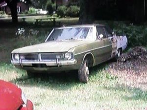

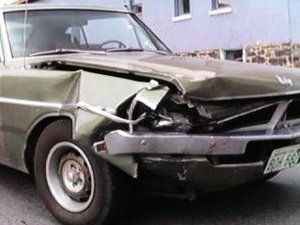

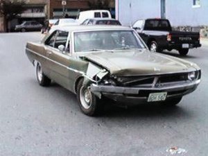

Well, What can I say. All good cars come to an end? Keep in mind that this 70 GT was my Wife's car. So, Who wrecks it? Why, freakin' ME of course - UGH!
The 1st wreck; A Mitsubishi turns in front of me... Lady looks up... sees me coming... STOPS... Crunch, I broadside her! Damage to Mitsubishi: $4500.00, Damage to 70 GT: $1800.00 No Total out.

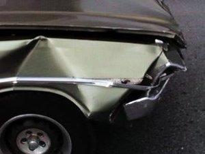

Not enough damage for me? 2nd wreck; (8 days later on the way to body shop for estimate) A Honda turns in front of me... She stops and I swerve to go around her... She pulls foward another 10 feet... CRUNCH again! This time I come out of the car raving mad! The girl locks her doors to save her from the raving long haired, bearded madman circling her car screaming at her - Me. I then calm down and we call the cops. Damage to Honda: $1000.00, Damage to 70 GT: $2500.00 No Total out. This time I am injured too - Damage to me: $5800.00. Off to the hospital.
The only bright side to this I can come up with is; The hits were both on the Passenger side, NO Frame damage, and Wife did NOT kill me provided I am NO LONGER to drive HER 70 GT! We used the settlements to purchase ALL (and I mean ALL) the restoration parts for her.

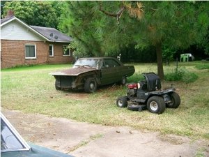

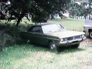

Then I found this 70 Swinger in Winston-Salem, NC for parts: $200.00:
We used the Hood, Grill, Valance, & rusty Passenger Fender from it. I Kept the entire Dash and 318 Short Block (it HAD a 340 Intake and Carter AVS on it when I bought it - came up missing when I went to pick it up!) Then sold the remaining carcass in 2007 for $600.00!

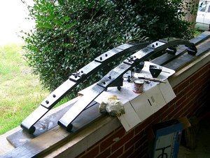

August 2008 - Now have the new Springs in - of course the Brakes are shot. New Brake parts ordered and received 9/05/08.
More later,
Bruce B.

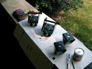

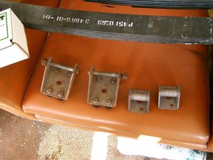

Here are the Front Mounts & Shackle Mounts - before POR-15;
After coating with POR-15 Black;
All Mounts & Springs after coating with POR-15 Black;
Right Side installed;
Left Side installed;
Also, I used new Shackles, Bushings, & Axle U Bolts.
I will open the Rear End up to see what Ring Gear it has since I am putting a new Cover Gasket and Oil anyway.

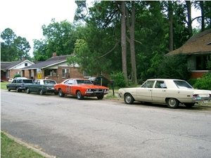

Here she is back on the ground!
And the gang at my house for 5th of July cookout.
Later,
Bruce B.
